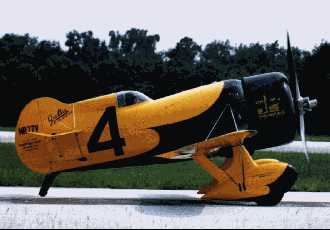

Here's a side view to help in strut placement.

Thank you for the piture but it didn't help me after zooming up the picture was so griny that it was no use. Is it for wires to hold the stab (mount fish eye hooks) or what ?
