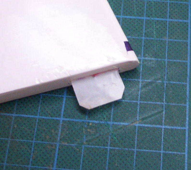

First off let me tell you guys that this is the first time I have ever used CA hinges on anything bigger than a .40. Secondly I am not crying and bashing Great Planes.
I finally got a chance to fly a pattern plane that I designed today and on the second flight the left elevator left the plane and took the left horizontal stab with it. Well needless to say I did not get to land it. I had 2 people standing next to me and they saw what happened so at least I did not have to try and remember what happened in the last 3 seconds of flight. I used GP CA hinges but before I decided to install them I read several how to's and felt they would work. Well as you can see in the pictures below all the papre/fuss came off the hinge (the plastic middle section) and off came the elevator. All that is left of the hinge is the slick plastic section where the paper/fuss is supposed to impregnated onto. There is no way the paper/fuss could have stayed on because the plastic underneth it is totally slick.
At first when walking up on the wreckage it looked like the CA hinges had pulled out of the wood but upon closer inspection that was not the case at all.
Do you ever get that funny little voice in the back of your head that says "This Won't Work"??? Well I got that feeling several times but I did not listen to myself.
I am showing you guys this in hopes that if anyone is using the GP CA hinges to be aware of what happened to me. I will call and talk to customer support in the A.M. to hopefully make them aware that there might be a bad batch of hinges floating around...and no I don't expect them to pay for a damn thing because it is just one of those things that happens.
This was a costly lesson(2-Hitec 5645's, O.S. 91 FX with Tuned Pipe, JR PCM Rx)...[]
This is the first time in 30 years of RC that a hinge has ever failed on me ...I always use the Robarts or the Du-Bro 1/4 scale hinges.
The pics below might be a little fuzzy but you can see where all the paper came of the hinge surface...as a matter of fact you can scrape the paper with your finger nail.

having used Great Planes CA hinges a BUNCH, and abused heck out of them... I've never had them fail without good cause.
I'm not saying its impssible that you got some bad hinges... I just haven't seen one before.
I HAVE seen them pulled out similar to yours from aileron flutter. The ailern gets to making a buzzing noise as it wiggles up and down VERY fast. This is yanking the hinges up and down, and can exert enough force to delaminate the layers of the hinge. You THINK yo slowed down enough and stopped the flutter in time... but you land to inspect anyway... and the aileron comes off with a gentle tug.

Please help me understand what you're saying happened, here. I see 3 fuzzy pictures of the stab only, no beveled surface in the pictures. I read the term about "delamination". The pictures of the stab clearly have a part of the hinge left in, are you saying it is only the clear plastic part left?
Are you saying the two pieces of Tyvek ripped, on both sides of the hinge?
Is the remainder of the two pieces of Tyvek fabric still in the stab?
Are there two remaining pieces of Tyvek fabric still glued to the tapered elevator surface?
If so, that would mean that both top and bottom pieces of Tyvek ripped at the joint line. Please clarify.

Dave...what you are seeing is the horizontal stab half...sorry about the fuzzy pics...my digital is a rather cheap on and does not do good in close up shots. The Tyvek was ripped off both sides of the hinge inner piece. The remaining Tyvek is stuck in the elevator half..there were some hinges still in the stab halves but some were pulled out just like the elevator halves themselves.
I did talk to GP and while they were sorry it happened they say I am the first person in 4 years that they have been selling the hinges to have a problem.
I had some of the 2"x9" hinge stock that came from the same package as the hinges I used in the plane so I did some testing using my fingernail and I was just barely able to remove any of the Tyvek until I wicked some thin CA on a 3/4x3/4 " piece and it was pretty easy to scratch the Tyvec off....dry non CA'd Tyvec was very hard to to scrape off. I wish I had some answers if only to make me feel a little better about the failure...and that is really what this was..a failed CA hinge.
I am pretty tough skinned after 30 years of flying and have another of my designs being plotted and will start cutting wood tonight but to loose one of my own scratch built designs in only 2 flights set me back...but only for a little while. Who knows...this may never happen again to anyone but I wanted to make people aware so they could make thier own judgements about any future CA hinging they might be thinking about.
Sorry for the fuzzy pics but my Kodac 2.2 mpix is only good to about 8" close ups. I guess you just have to see the hinges in person to get the full drift of what happened...hell I am as confused as anyone right now but I will be using different hinges for a while and maybe leave the CA hinges dor different projects in the future.
The only thing I might have done wrong was..dang..I can't think of anything I did wrong...oh well live and learn but I appreciate all the concerned responces...

Thanks for the elaboration. It sounds to me like the fabric actually tore, on both top & bottom of the plastic - and that makes me question the material! That Tyvek stuff is pretty much impossible to tear. Having multiple hinges on the same surface, all torn both sides.... I'm having trouble believing that was Tyvek. Which it should have been.
One more question, though. When you hinged this... was there any gap at all? I ask because a tightly hinged elevator, with no gap, would cause some serious stress on the fabric, with each big deflection. Not being cricital, just trying to learn more about the possibilities, here.

Damn Dave...I did have it very close...touching (gap closed)...I always was able to get a near gappless joint with the other hinges and I noticed that when I CA's these the elevator was kinda hard to deflect...I just never made the connection...I thought it was becasue the CA had stiffened up the Tyvek. I am almost sure that is what happened now...damn do I feel stupid[:@]
I would have never made the connection...looks like I goofed...DAMN. Well thanks for all the help guys...but I will use Radio South CA hinges and do it right. When I did the scarpe test this morning I was having one hell of a time trying to get the Tyvec off and I was really shocked to see how much of it was gone of half of the CA hinge but it looks like Dave has solved the Mystery...thanks Dave..I think[&o]

Pinning it would have probably saved it. I have had this happen when there is not enough CA on the hinge and it has not wicked properly. I use a T-Pin, cut it off flush, then put a small piece of covering over it. THEN I seal the gap with clear Ultracote. Never had a problem since I did this. I lost a Sig Kadet Senior to aileron flutter, and the hingle looked just like that...Learned my lesson.
