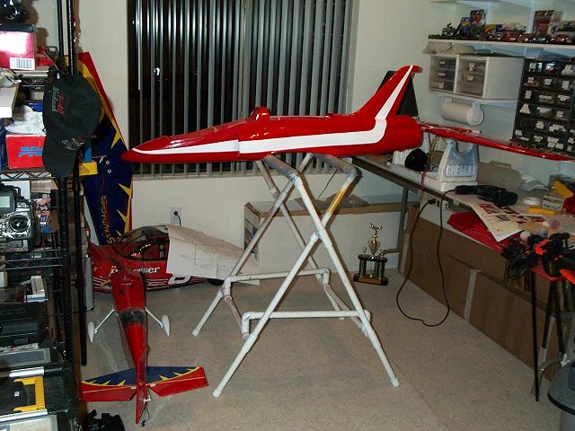

Not sure if this is what your looking for, but is made out of 3/4" pvc. If you don't glue it completly together, it takes down pretty easily. To use at home and at the field. I have 2. One for the house, and one for the paint booth.

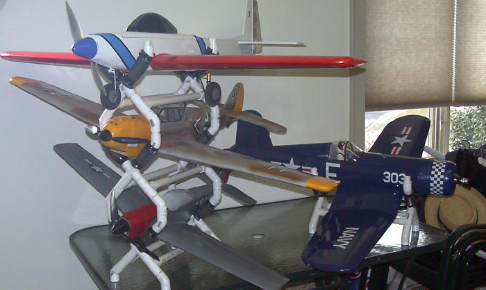

Here is the way I store and transport my planes. Racks come apart at the field and I have a short stand for each plane. (3/4" PVC.)

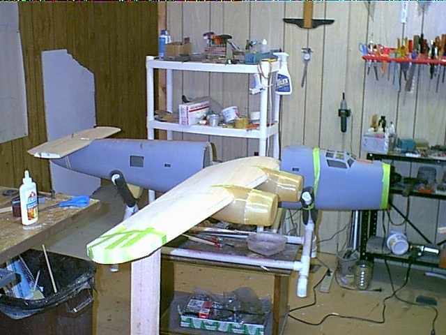

I use stands like JimFinn is using. I have several in different sizes. The one in this pic is screwed to the old tv stand so it will roll around the shop. It is also set-up for some PVC legs that will plug in if needed. Just some PVC pipe, crosses, & tee's.

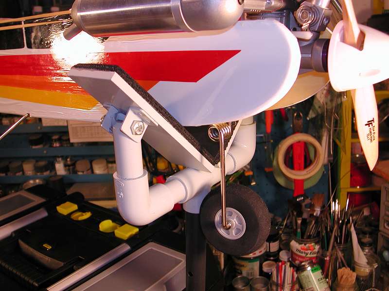

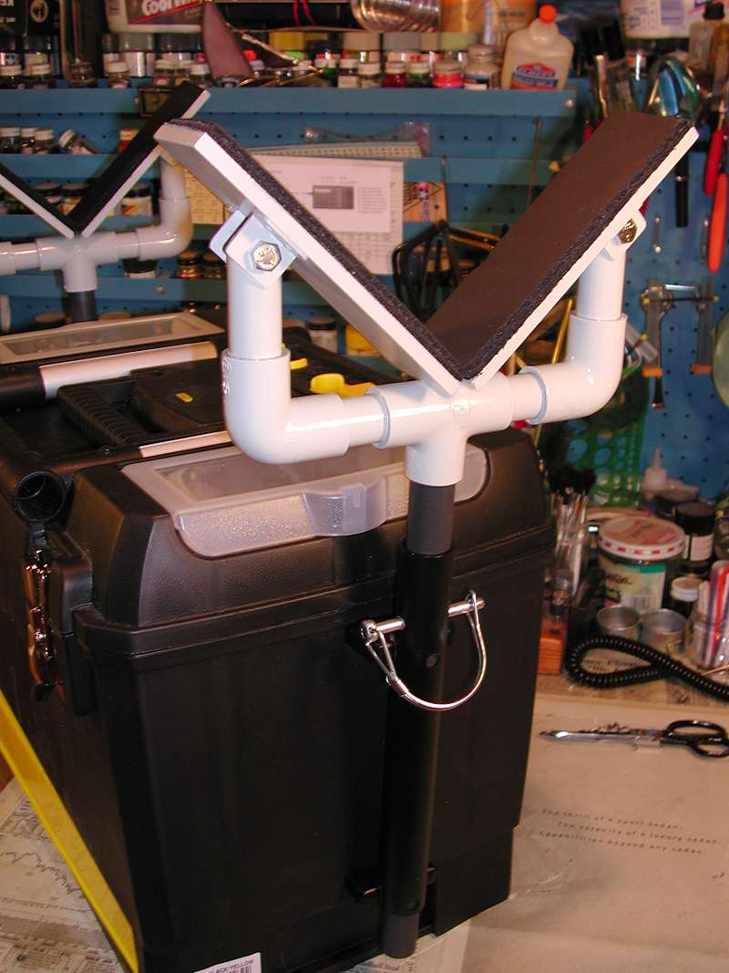

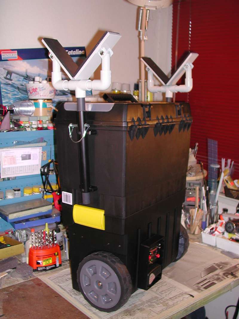

Robart makes a styrofoam stand - $15 - the 45 degree paddes supports are very solid and allow work on the fuselage at any angle...
http://www2.towerhobbies.com/cgi-bin...?&I=LXES03&P=7
Liked the idea so much, I "adapted" the idea and added it to my field box - God bless PVC!!
