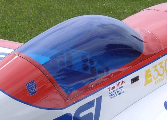

I mentioned using Testors transparent paint to tint a canopy, here's how it looks. I used blue to match my paint job, but they make a smoke tint, and several other colors. Spray mist coats, adding coats to darken to taste.

OH, I like that a lot, Tim_Indy.
I looked for the Testors at my LHS on Saturday, but they didn't have it, so I opted for the other.
The Testors looks much more like a good Rit Dye tint. Just what I wanted.
I may bite-the-bullet and strip the Practa and search for the Testors.
Thanks for sharing the picture with us.
