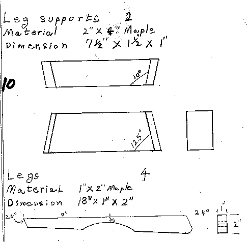

Great field box and great solution seperating the battery/fuel in a smaller compact box. Did you build this from plans?? How about some more pictures BTW how do the legs work???

I designed and builted these boxes about 25 yrs ago. They have been very durable. Back then I built and sold about 27. However I do not enjoy building any more. Now I am working on a set of plane for the box. Some friends of mine want one of the boxes.
We are going to cut out six or seven ( It is a lot easier to cut them out in multiples). The guys getting the new boxes are going to do the assembly. With my guidance. I think the actual cost of materials will be less $30.00. I am going to try and make a set of assembly Dwgs. I hope I am that good of a draftsmen. We'll see. This box is varnished with boat varnish. Hot fuel or chemicals like acetone will not touch the finish. The right side open space will now have two drawers, one over the other. Large enough for things like field chargers. The back side of the box will have fold outs to hold a small wing.

You asked earlier about the legs. I have included a sketch (not Completed of the legs and the support that they are mounted on).
