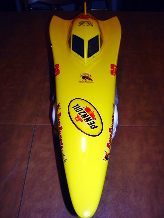

ORIGINAL: doggscube
I'm hoping to print my own decals using Avery/equiv. clear sheets (pictures of my kids to use as pilot/passengers in my LT-40 ARF). Can I do this in this application? Do I need to seal them?
Jeff
Yes, the Avery sheets will work. If you print out on the clear you will need a very light background. Might be better to print out on the white sheets and trim closely.
You must definitely seal them. I use either Krylon or Rustoleum clear on non fuel applications and Lustrekote clear on a fuel application.
Here are pics of a boat I did the decals for using Avery label sheets and cleared them with Rustoleum:
