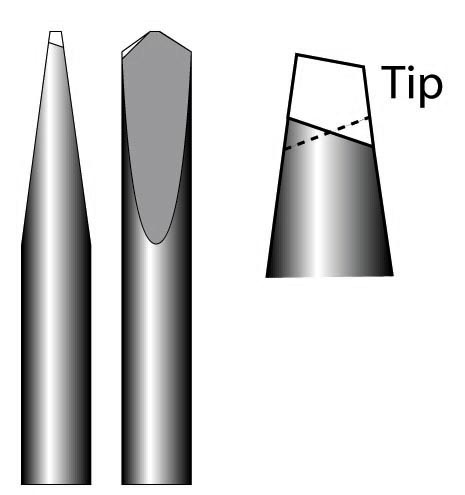

Try this...
Get a small drill that you can dispose of (or anything that's made of tool steel)
Using the shank end, grind a "flat" like a screwdriver then point the tip
Next, grind the tip to an angle that will cut when rotated counter-clockwise.
What you have made, in escense, is a spade drill that will bite into the screw head and (hopefully) screw it out.
