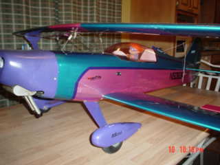

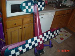

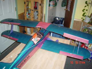

Thanks for all the great info. I think I'll take it out tonight and get a picture of it to post before I start the stripping process. [sm=drowning.gif]Just hope I don't get in over my head
Old 09-10-2004 | 10:25 PM
ace1991's Avatar
Joined: Apr 2004
Posts: 37
From: E. Dublin, GA
Default RE: re-cover super skybolt
I'm trying to post the photo's. This is my first time hope it works if it does don't laugh it was only my second covering job. I'm not sure what I was thinking with the colors.[img][/img]

Old 09-10-2004 | 11:40 PM
GrnBrt's Avatar
Posts: 6,988
From: Everett, WA
If that's your first then you did good but the colors may disappear on you so keep a good eye on the plane and remember your inputs. I would have continued the checks onto the ailerons though as it would look a bit better. I am doing an ultimate right now and plan on the checked bottom of the wings and yes I am into self torture!!![&o]

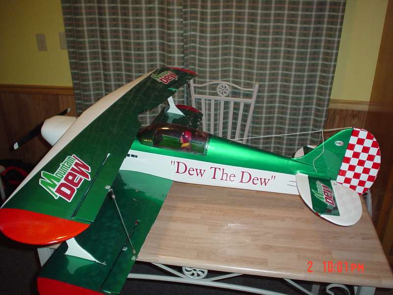

Well I finally have the plane recovered. I ran in to a little trouble with the fuel soaked balsa under the fuel tank. Thank goodness for K2R worked great. I not sure what I have done without RC Universe and all of you. I still have to get some Mt. Dew stickers and hook up the push rods.
Here's how it's looking so far...

Here's the finished product. I think it turned out great. I'm very pleased with it...

Old 11-02-2004 | 10:34 PM
Deadeye's Avatar
Posts: 4,516
From: Dutton, MT
Nice work. It makes me thirsty just looking at it.

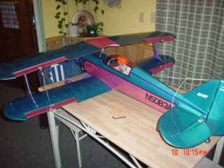

I went back and added some stripes..
