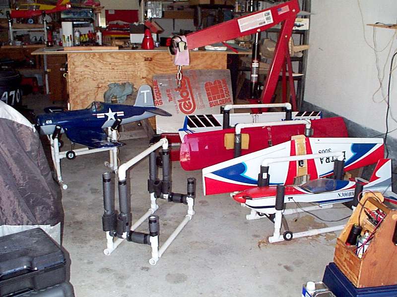

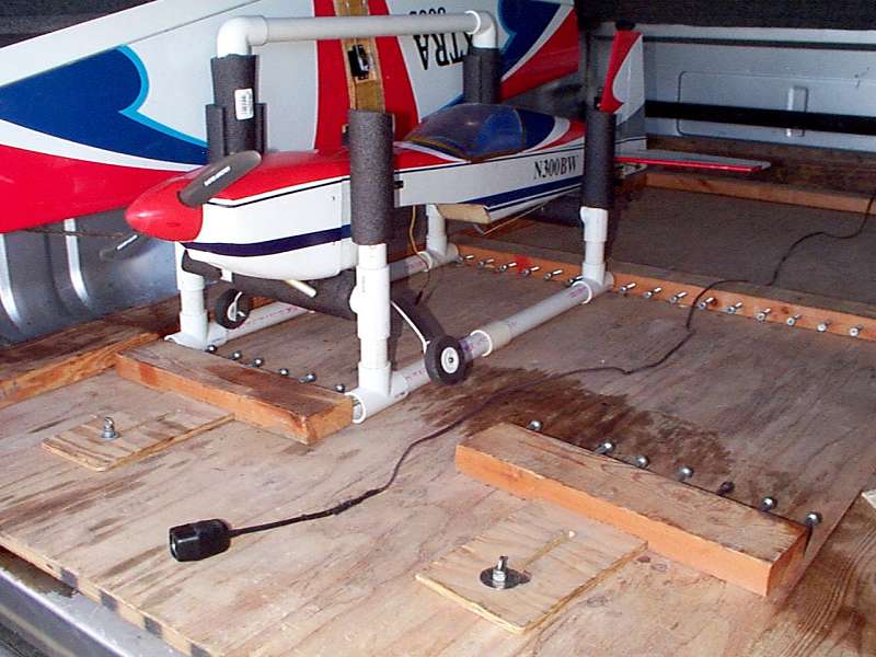

This is what I do. I make enough to cover most types of planes. The other planes not in cradles are in a rack. Not very suitable for giant scale but works for around .60 sized. The cradles are pined to the plywood for easy access.

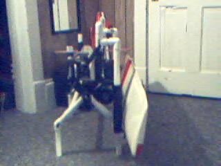

My stand is made of pvc 1" pipe.

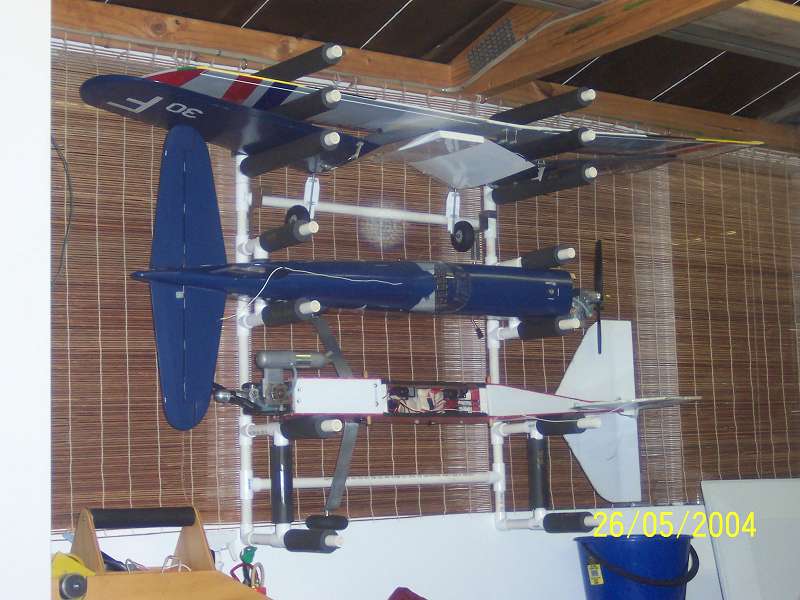

O'kay fella's,
here is a couple of pics with what i came up with .
Made out of 15mm pressure pipe.
This rack had to be designed to fit in the back of my truck .
So had to work to a 450mm high maximum size.(with cover on )
I also wanted it to double for storage.
Just hangs on the wall on two hooks.
Will post pic later of set up in truck.
Pic shown is inside in "truck mode".ha ha ....
This will take my trainer + GP corsair and have made outside rack to accomodate my GP60 extra (still building this ).
So can carry a combination of any two .
cheers for your imput.

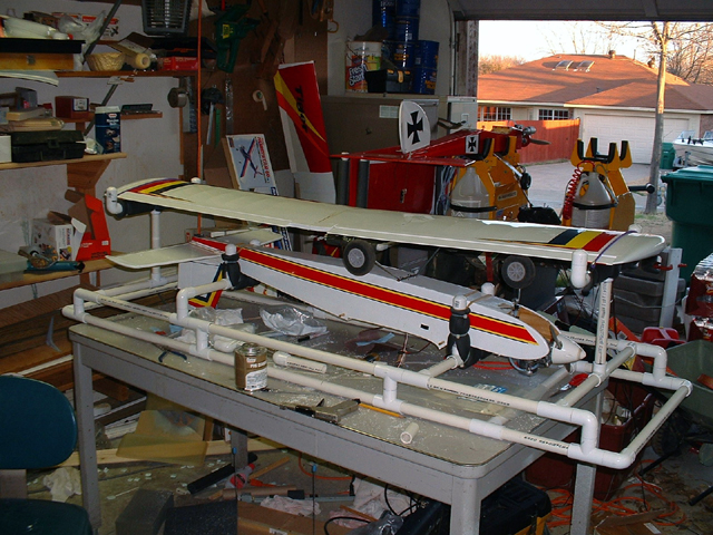

My brother built this one for me. It's made of 3/4 PVC and the 'dual rail' design is rigid enough it can lean against the wall for storage in the garage; and it's easy to drag around by one end. By making the bottom of the frame longer than the wing, it prevents the wing from being damaged by sliding forward or backward in the truck.

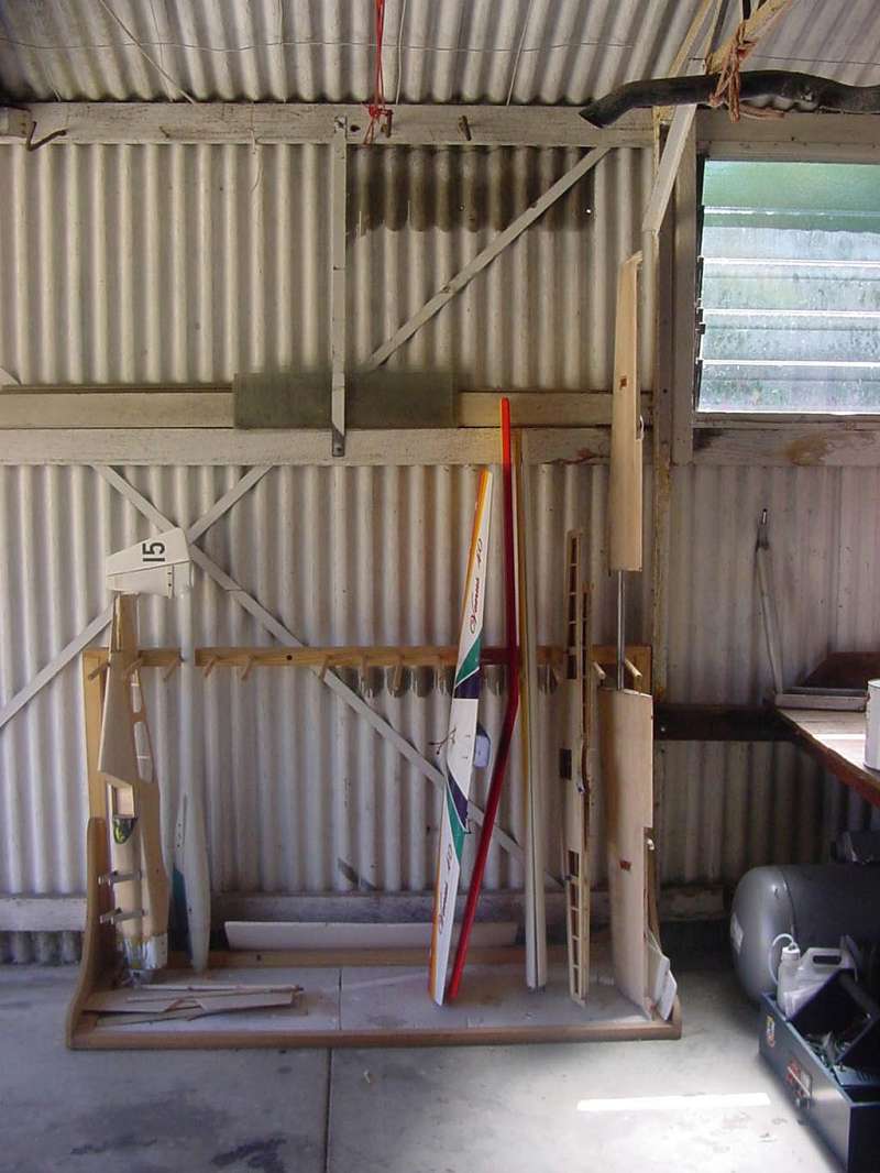

My dad is great with wood working and has every tool imaginable. He makes these for us out of scrap wood. This one in particular is made out of the old cabinent door from the bathroom before the remodel. Biggest cost in this stand is the pipe insulation used for padding! [8D]
This stand is light and will transport any 40 size plane and works great for a work stand on the table top at the field. Makes running the engine up a one man job while in the cradle!
