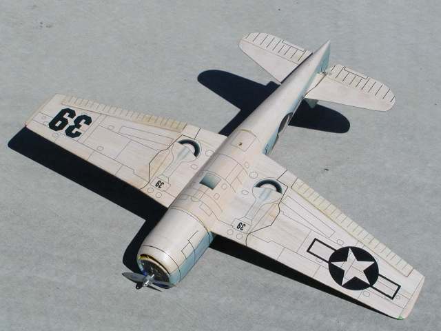

ORIGINAL: Deadeye
Really? I'm not sure I understand how the CG can shift, when the LG is anchored to the same point?
The LG on these planes do not retract inward toward the fuselage like on the P-51 Mustang. Instead, they rotate and retract rearward into the wing.
Attached are three pictures showing the side view and bottom view of the F6F Hellcat. The side view shows where the wheels are when they are down. The bottom view shows where the wheels are when they are retracted. As you can see, when the wheels are down, they are in front of the CG. When the wheels are up, they are behind the CG.
ID:	224025   Click image for larger version
ID:	224026   Click image for larger version

Roger that, I understand how they retract. But would you help me understand how it can affect the CG when the landing gear is anchored on the same point? When retracted, the gear is indeed back, but the mount doesn't change. Isn't that where the weight is, on the mount? I just don't get it. Thank you.
Old 02-02-2005 | 02:11 PM
Richard L.'s Avatar
My Feedback: (24)
Posts: 8,788
Received 4 Likes on 3 Posts
From: Renton, WA
Default RE: Variable CG?
Most of the weight is in the wheels, just like the weight of a pendulum. The mount doesn't change, but the weight shifts from one point to the next. You might be thinking too hard. The CG is affected by weight and how far it is away from the CG (moment arm). It doesn't matter if the anchor point doesn't move. The strut acts as a moment arm. When the wheels are up into the rear of the wing, they want to tilt the nose of the plane up. Put your plane on a balancing stand and put a pair of wheels on the leading edge of the wing. Now move the wheels back toward the trailing edge of the wing.
Old 02-02-2005 | 02:28 PM
Deadeye's Avatar
Posts: 4,516
From: Dutton, MT
ORIGINAL: Richard L.
Ah, now I get it. I wasn't considering the strut. Thanks for clearing that up.
