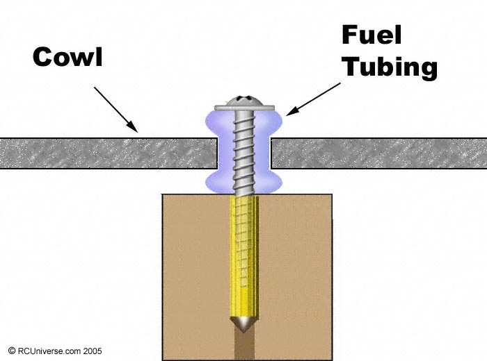

If you drill the hole slightly larger than the screw you attach it with, then put a piece of fuel tubing in the hole and then put your screw in. The fuel tubing will act as a "shock absorber" and isolate the cowl from the vibrations. A little bit of nyrod inserted in the wood also helps to keep the screw from vibrating back out. see attached diagram. I've done more cowls like this than I can count and it works every time.
Hope this helps

A grommet from a Futaba servo works really well in place of the fuel tubing because it already has a groove in it to hold it in place on the cowl. It works easier for me than the fuel tubing did.

I have to say that I looks like RCKen and Sebo 's solution is the best. I don't see how the PSP cowel binders isolate the coweling from vibration the way fuel tubing or gromets would. Why set yourself up for a future repair of a cracked coweling. How much are the PSP binders? I have alot of spare gromets, fuel tubung and nyrod.

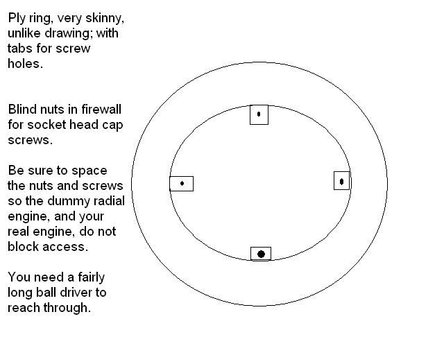

The Kyosho AT-6 had a cowl mounting method that did not show at all, and no screws actually went through the fiberglass.
A thin plywood ring gets epoxied inside the cowl, near the rear. Blind nuts are installed in the firewall for socket head cap screws. I attempted a drawing, please don’t laugh too hard.

Carrell, what you're describing is known as a cowl ring, which can be a good solution with kit built or scratch built models, and keeps a clean appearance for scale models, but may be too complicated for many ARF buyers. It's not always easy getting the blindnuts correctly spaced on the firewall interior. I've never seen a laser cut cowl ring supplied with an ARF, but then again high end scale ARFs are not my cup of tea.
