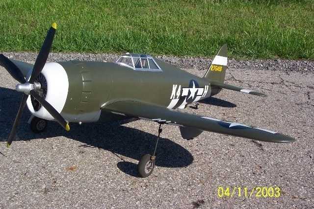

The Nelson flat clear doesn't stick worth a hoot! Blue, low tack masking tape will pull it right off. It's got more of a satin finish than flat. If you want to send me a small painted panel, I will clear coat it for you and send it back to you for testing. I'll stick a picture of my new Jug on here for you to study. Notice the satiny finish.
