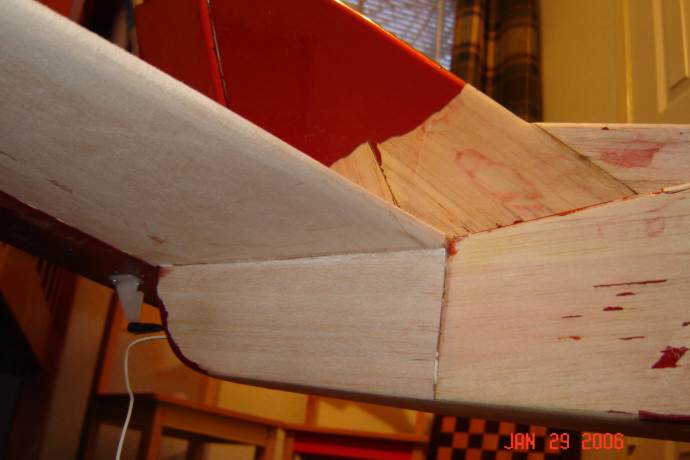

Some lessons we learn come easier than others. As I am in the age minority here I'm sure this is of no great revelation to any of you. I've only been involved in this hobby for only a few months and the knowledge I gain from my hard lessons grows by leaps every day. Yesterday was one of those lessons.
Walt has been instruciting me teaching me to fly these things. We flew my Kadet the other day and had some kind of onboard malfunction that brought us down after a few minuites. Walt seemed to think it might have been the engine dying. Whatever the case, he felt that the Magnum .40 wasn't enough engine to pull us out of a jam and certainly not enough power to have any fun with. So Walt loans me one of his engines, an OS .46 FX. He brings me the engine wich had a 10x9 apc prop on it and suggests tying off the plane and running the old engine then swapping the engines and running it to get a comparison. That got the wheels turning in my head. So I decided to build my own Thrust-o-meter, using an old fish scale I had in my tackle box. I had now completed the make-shift meter, time to make some noise!
I ran the Mag .40 on the 10x6 and got 4.75 lbs Thrust. I ran the OS .46 on the 10x9 that Walt loaned me with the engine and got 4.25 lbs thrust. Ok.....So I swapped the props. I started the engine up, brought it to idle, checked over my rope and other things before opening it up all the way. I inched up the throttle little by little adjusting the air mix along the way until I found the sweet spot....prepare for lift off.
I ran the throttle all the way open gradualy and managed 6.5 lbs thrust on the 10x6 prop before the tail section let go and sent the plane crashing through my carport/garage area. The prop shattered on the wheel of an old car I'm working on. and the tail section was damaged pretty good. As I stood there wide eyed and disbelieving, I was vaguely amused. As no body was hurt and no property was damaged(except my pride) The whole thing became funny.
Walt said the other day"either you become a good pilot or a good builder, cuz if you aint a good pilot you better be a good builder." seems very true for me. Thats ok though. Maybe God wants me to be a good builder before I'm any kind of pilot.
The incident reminded me of when I put a .45 ACP hollowpoint into momma's new carpet, but thats a different story for a different board.
So whats the lesson?....I'm not sure exactly But I'll be alot more careful next time I whip out the old Thrust-o-meter and when I do I'll get it all on video!

Too bad about the experiment! One thing to keep in mind is to carefully re-check the CG after your rebuild/repair. You are likely to be tail heavy as a result of the materials and epoxy used for the repairs, and I don't want your next trip to the field to end up with a tail heavy plane that goes in!
Good luck.

The problem with the staic thrust IMHO anyway. The 10x9 is going to unload in the air. Not that the 10x9 should ever be run on a trainer but in the air it would build more speed with time than say a 12.25x3.75 apc. Thats what it's built for is speed. The longer lower pitch prop is a lot better for a trainer. While it wont have the speed the throttle response will be much better. This is what gets you out of trouble with a trainer. When I buddy box someone I want instant response when I let go of the trainer switch.

There is a lesson here about props. That 10-9 prop is the wrong choice for a mild 40 engine, flight training, or accelerating out of a jam. High pitch props do one thing, basically, and that is generate straight line speed. A high pitch prop will lessen the plane's rate of climb and lengthen the takeoff roll. Lower pitch props generate less speed, but climb and accelerate better. And that's what you want in training and sport flying. Modern 40s do very well on 11-4 and 11-5 props. APCs are generally more efficient than Master Airscrew, for instance. Experiment until it flies the way you like.

Pulling the tail feathers off a model which is tied down for engine testing does NOT mean doing so is a bad idea, it means the tail feathers weren't up to the task of holding the model back under full power. The 'lesson' is that models must be built so they CAN BE tied down during full power runs, not because you will always do that, but because you should tie the model down somehow while starting the engine to be _safe_, and you don't want to get chewed up by the prop if you happen to go full throttle _and your model restraint fails_.
Four or five years ago My Dad decided he'd jump back in the hobby after a 20-year absence (he soloed back in the 80s unsing my old student trainer, but never did build his own model). He bought a trainer, flight box, starter, yada yada yada. Borrowed my old but rebuilt K&B .60 and an old Futaba gold-face FM radio system. The engine had not been run since it was rebuilt by K&B a decade or so ago, so I gave him the instruction sheet for breaking it in all over again. He got it all about right, when he clamped the engine to his flight box for a break-in run on the ground. He set the 20-odd pound flight box (with 7AH lead battery inside) on the concrete patio deck, filled the temporary fuel tank, primed the engine, etc., etc., etc. The engine lit up on the first flip just like I told him it would. The bad thing was that Dad had the throttle open about two clicks too far, and the old K&B proceeded to TOW THAT FLIGHT BOX across the patio. He got one shot at the Tx and missed. He showed up at my front door a few days later, handed me all of the stuff he'd bought and borrowed, showed me the 23 stitches in his index finger, and declared that model airplane flyers were lunatics.
Accidents _will_ happen. You just had one, and because you're just getting started in this nutty hobby, there are no doubt more in your future. Do not have an 'accident' because your model could not stand being tied back during ground engine runs.

For what ever you think it is worth here are some of my thoughts. As you have already seen the damage of a tail section that could not withstand the thrust of open throttle, does anybody think it is a good idea to hang a plane from a "divingboard and scale" to measure thrust? I would not do that with any size plane regardless of the size or source of power. I saw the method that NJ Georgee is refering to being used on a cd rom motor foamy and I don't think I would trust even that to be safe with only 12 oz. of thrust and 10oz. of aircraft weight.
I agree with kdheath that power is not always the answer when in trouble. I have been teaching rc flying for ove 15 years and still believe proper control surface commands work better than brute power. I teach novices at no higher than 1/2 throttle untill they can land consistantly.
the_plumber is right about it's better to learn that the tail section was not up to the task while you were still on the ground. If the plane had been in the air when the tail let go the plane would be toast and someone could have been hurt due to the lack of control. Thank what ever Great Powers you believe in that no one was in front of the plane when this accident happened.
I hope you can make proper repairs soon and get back to learning to fly. As one of the guys pointed out, be sure to rebalance after the repairs
I'm not saying your instructor is wrong about wanting more power. Just remember that the Sig Kadet series of plane are a design that has a high ratio of design drag. I have had a lot of time with the Kadet Junior, MkII and the Senior and all of them are a great trainer BUT are not fast planes. They are made to float along and give you plenty of time to figure out your attitude condition and make a correction.
Good luck with your learning to fly. I hope you learn to be both a Great Pilot and a Great Builder.

I understand what you guys are saying and I don't disagree. The tail section was weak due to a crash a couple days earlier. As you say...It's better to find this stuff out on the ground than in the air. I have pretty much completed the repairs, just need to cover the nekkid spots
