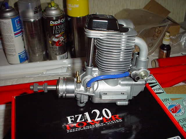

I have my Model Tech P-51 (.60, 65” ws) in the basement ready to finish and finalize, but I’m a little concerned about the engine I purchased for it, only because of what I’ve heard and not experienced. The plane should normally weigh out at 10-11 lbs. w/o retracts and I currently have Robart Mechanicals in it, but have thought about Spring Air if they’ll fit.
Now I ask you, besides the type of plane in question here, will the OS .91 Surpass II be sufficient for this bird or do I need to upgrade to a 100 or 120? When I state sufficient, I mean with some authority, scale, not a piper….sorry piper flyers out there.

11lbs nearly 5kg is rather heavy and your .91 FS will not fly it with great authority...but it will fly in a scale like manner!
If you want more oomph! Get a 15cc twostroke...like MVVS 15cc engine. A 20cc (1.20 ) fourstroke will only make matters worse

An 11 lbs. is rather heavy. The .90 will fly it, but if
you're looking for some authority, and are set on a
4-stroke....get a 1.20. You will have a pretty high
wing loading already....Put some motor in it !

Can't see you milling around with a mustang. The horse wants to run. Watch the flaps on takeoff. If you take off with them on, and try to climb steep, you could end up in a tip stall, spin situation and that will be the end. Make sure you climb out fairly flat till you learn the flight tendencies of the plane. Have fun

I agree....the Saito 1.00 is not enough power. A 1.20
O.S. Surpass would be good, or the O.S. 1.08 FSR
two stroke is a brute.
I would have put the YS 1.20 (supercharged) in it.
Forget the flaps for take-off....let it run out at full
speed, before you ease it up....the flaps are cool for
landing....but keep about 3 clicks of throttle on it,
bring it in fast, and grease it in. Don't try to float
it in !!!
Done Deal....Dave.
