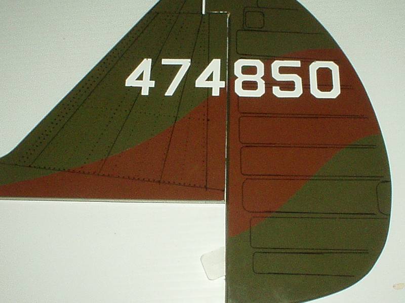

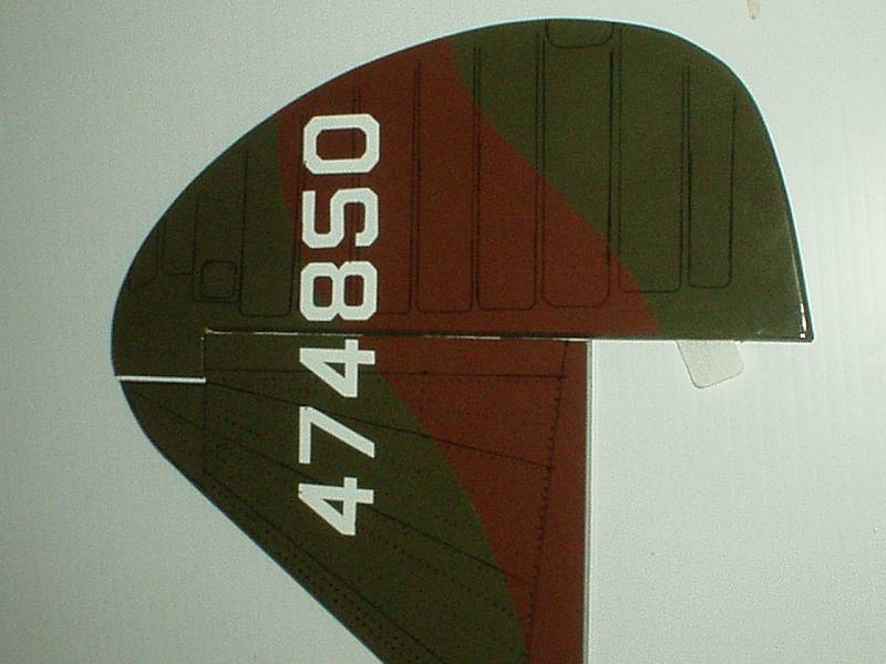

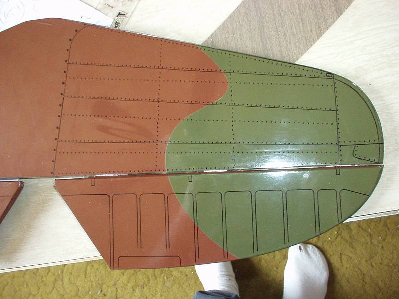

Ok I started putting on the panel lines and the distressed paint simulation.
One problem that I am having is getting the shading along the lines. I live in a small town with out an art supply store and know one hear seals a carbon pensile. I have tried both graphite and lead pensile shavings with no success. Also I have tried graphite. Nun seams to make a mark on the ultracoat.
Dos any one have any ideas?

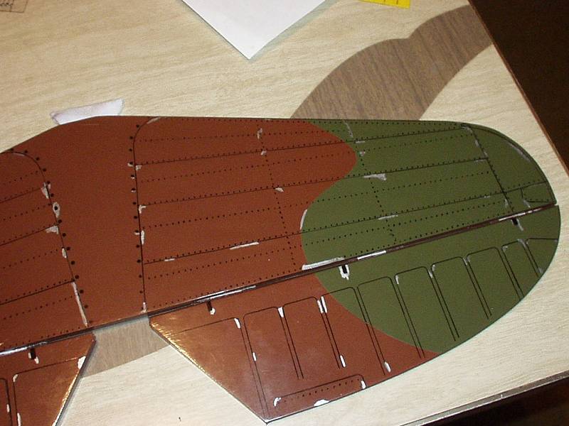

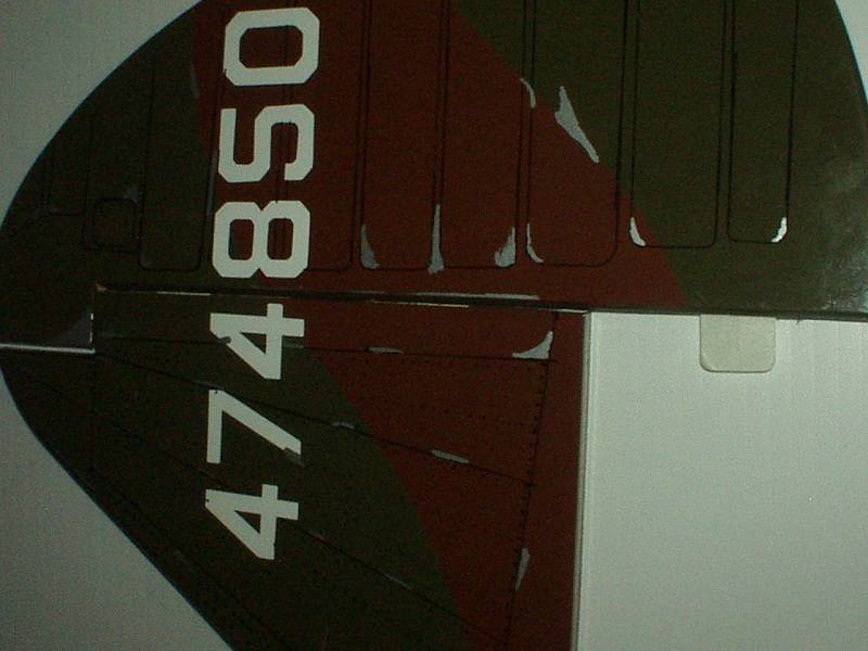

Here are more photos of my hanger 9 P40 detailing project. Things still look a little cartoonish. I plan on spraying with Top flight flat clear Lusterkote. Dos any one have any suggestions?

Hi there,
I am sorry to say that your assesment is correct regarding being "cartoonish".... Here is how you can achieve a much better appearance for your warbird.
1. Remove all the weatherings you have applied using rag soaked with thinner.
2. Use steelwool grade 00 (I think 000 is way too fine) and rub all over until you have a scratched appearance on UC.
3. Wipe clean with a lint rag.
4. Use FLAT clear Lustercote ( but first let the can stand in warm water for 5 minutes).
5. Spray for 3 seconds, stop to clean the nozzle and shake. Then do it again until the whole A/C is painted.
6. Let it dry for couple hours, then use a black Sharpie (use the fine tip) to draw in the panel lines.
7. Mix some silver paint with black to tome down the brightness and apply along leading adges and panel lines to simulate paint chips.
8. Apply another thin layer of LC to seal the weathereing.
Good luck... You can find the art of weathering on plastic modelling section on the Net. DP
