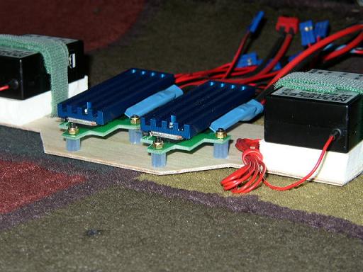

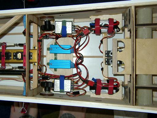

Or, for those with alittle bigger planes and more room to work with, here're some pics. The board is suspended across the fuse on 2 pieces of foam rubber, one on either side of the fuse. Just had this brainstorm this winter.
