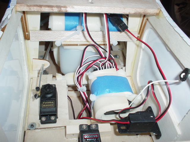

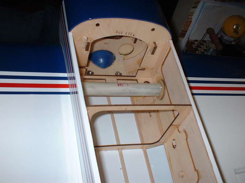

I am having a tough time getting my throttle push rod down to my throttle servo. The engine is higher than where the servo is mounted.
See attachment for pictures. Thanks in the advance for any help.
Mike

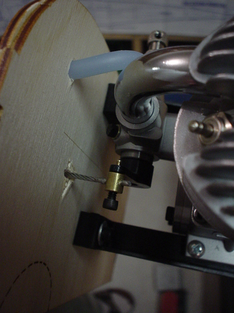

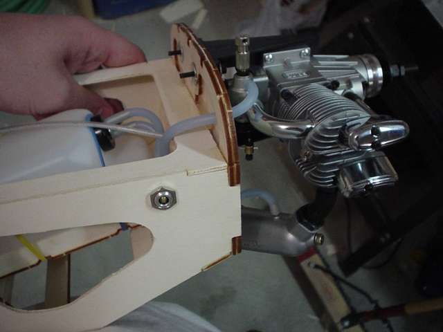

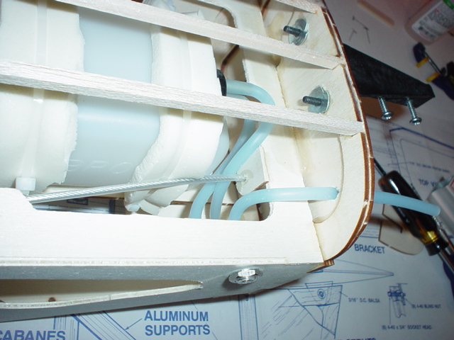

If you don't have a straight shot you have the option of using flex cable or some type of flexible pushrod. Here's the setup I used in my Ultimate. it had to bend around a fuel tank & some other stuff.

Thanks Tony. A picture is worth a thousand words. I am assuming you haven't had any problems with this setup.

It worked perfectly & there was no slack at all in the throttle. I unfortunately lost the plane due to a power switch failure on the second flight, so I can't give you a long term analysis.
I will be doing the exact same thing on the next one I'm building though.

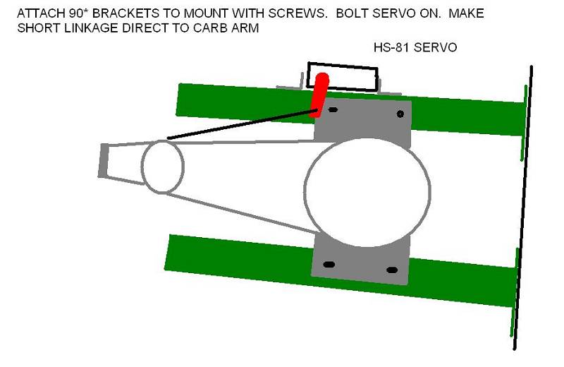

Mount a mini servo right on the firewall or on the motor mount with a small metal bracket. Then you have a 3" long pushrod and it's a straight shot to the carb. Not the easiest thing to mount up and fine tune--but it's the most trouble-free throttle setup you can use--once you get it set up and tuned right. I do it all the time.
BTW--that looks like the World Models 60 size Extra 330L.
I got the same plane with 90" wingspan and a Zenoah GT-80 twin.
I've attached a crude Paint image to give yo an idea. You can't do it like this, because of the pitts muffler. But, you can put the servo INSIDE the mount, right behind the engine backplate and run a rod up to the carb. Just make a little bracket from the left engine mount over to the right engine mount and screw the servo to it.
