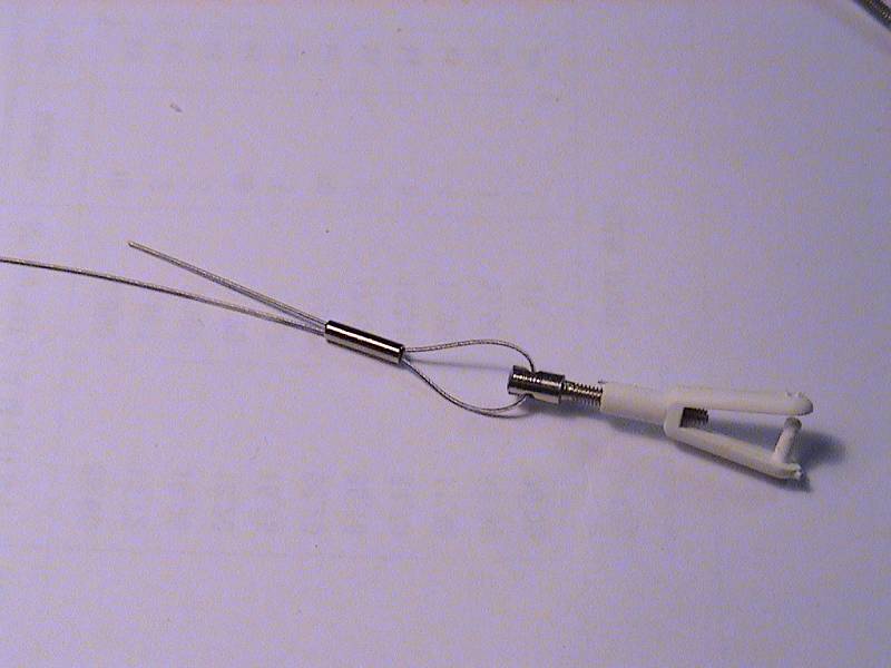

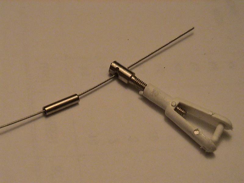

I am doing my first rudder & elevator pull-pull setup. This is on a 90 size plane. It has split elevator.
I am using Du Bro 4-40 plastic coated steel cable and couplers.
All of the cables are run and connected. The cables are crimped at the servo arm. Using one servo with arm horizontal.
I am having trouble setting the tension on the cables for the elevator halves. It seems that the goal is to get the cables past the 'slack' stage but not guitar tight.
What is the correct method / procedure to get all of the cables same tension and the elevator halves at neutral?
I seem to get one side set properly and then working on the other side the elevator half will be not be at neutral.
When this is completed -- if the elevators deflect either up or down the cable not being pulled is slack. Is this a problem?

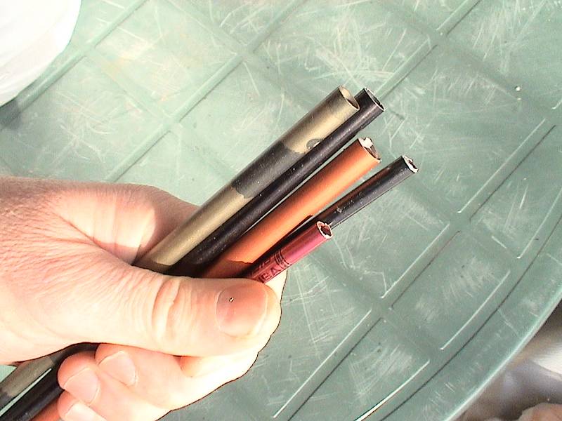

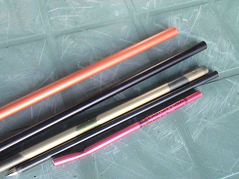

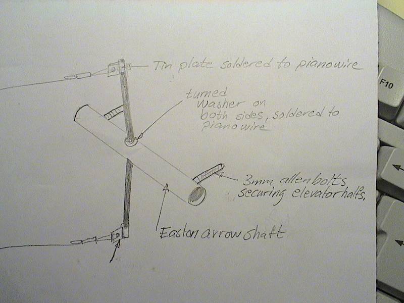

Why have a split elevator ??? Makes things harder to adjust! Why not glue the halves together with a aluminum arrow shaft (I use black Easton arrow shafts, lighter and harder than carbon)
I always have the adjustment at the servo arm, inside the fuselage. At the rear I just crimp the wire which minimises the ugly factor.
Here are some pictures of my modified U-Can Do .60 and some other airplanes

I will concede that Jaka's approach has its merits. However, to answer the question as it has been put:
Are you using some sort of threaded connector in your linkage? If so, set up the length and crimp so that it's as close as you can get to equal and minimal tension on both sides. Minimal tension means no sagging, but not tight. Then make your final adjustments by turning a few revolutions on your threaded connectors, then lock them with a jam nut when they're taut and neutral. A dab of thread lock will keep them set.
When you do the rudder, the hinge axis is vertical. Gravity does not deflect it one way or the other. Set the tension on either side so the rudder is at neutral with servo at neutral. Now if you roll the model 90 degrees, gravity will pull the rudder slightly down. Disregard this effect, as it will disappear in flight.
When you do the elevators, roll the model so the elevator hinge axis is vertical and adjust tension same way you did for rudder. Now when the model is upright, the elevators will sag a bit. Again, this effect will disappear in flight (or at worst, you'll need to nudge the trim button a bit).
