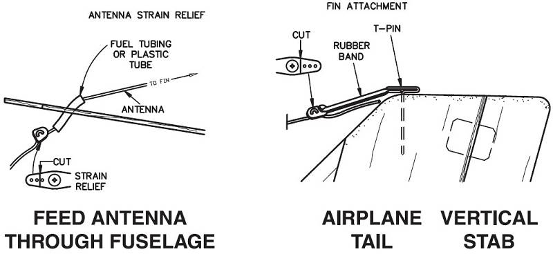

Just curious if anyone has any good simples ideas about how to secure the end of the receiver antenna to the tail of the plane?

Good suggestions. I use a small length of heat shrink tubing, (comes in colors), about 2" long, to exit the antenna out the side of the fuselage. To clean this little exit hole up, I use a brass eyelet that does not go thru the fuse. The heat shrink takes the strain off the antenna. Run back the side up to fin. On sport models, just put a T-pin to top of fin, tie antenna to a rubber band, slip over pin. Measure all so there is a little tension on the antenna, but not tight.
Good idea to also tie a half knot on the inside close to where the antenna exits from fuse on the inside.

I like to run the antenna through a drinking straw, or more usually, several straws taped end to end. In a long enough fuse it doesn't even need to exit at the tail, it will ride in the tube just fine.
If it does exit, be sure to provide some sort of strain relief where it enters the tube...like threading it through two holes of a button or part of an old control horn nut plate. I've been told (but don't know if it's true) that it's a bad idea to tie a knot in the wire for this purpose.

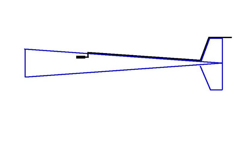

Hey guys there is nothing magic about antennas at either 50 or 72 Mhz. I have allways just run the antenna wire back to the rear edge of the cocpit and the up to the top of the verticle fin where I attach it with soider to an enlongated spring and then to the top of the verticle fin with a nylon screw and nut and on a "40" size trainer this leaves about 2 inches remaining to extend freely above the rudder. The antenna provided with most radios is a 1/4 wave long wire and is more influnced buy the metal control rods than length or routing. If you cannot rout it more than a wave length away from the metal control rods they will allways be the controlling factor. Just do it neat and secure and go fly.

For 40 and 60 size I usually just put a pin in the vertical fin and loop a rubber band around the antenna and hook it to the pin. I was always told to be careful about metal to metal that could generate RF interference. For 19 size planes I route the antenna to to the vertical fin then 90° down to the outside of the horizontal stab. I have been told this is actually good since the antenna is never straight on the transmitter.

I use the DuBro "Antenna Hook and Keeper". It's a neet install for routing your wire out of the fuse and connecting the end to the vertical stabilizer with a hook and rubber band. It only costs $1.39 at Tower. Here is the link......

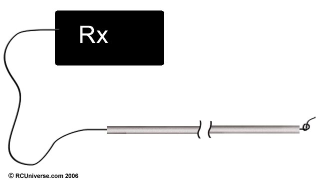

I've got a great way of doing it...
As you may know, i do a lot of product reviews of RC Airplanes, so my radios are constantly being pulled out of one plane to put in another. So any time I get a new Rx, I just run the antenna through an inner pushrod tube (In fact, Du-Bro sells theirs seperately as antenna tubes) then I tie a knot in the end of the wire so it can't pull out.
Then I just run the plastic tube down the back of the fuse as far as it will go.
Now, any time I need a receiver, I just pull it out of one plane, and stick it in the next.

I use the Dubro antenna keeper as well. makes for a nice clean install. I have in the past used the T-pin and rubber band method, and I like Minn's idea of the plastic tube... think I'll try that on the next one!

I like to take my antenna out the side of the plane and run it back to the tail. I secure it to the side of the plane with small 1" wide strips of monokote. Just iron down the monokote.
When it gets to the horizontal stabilizer, I run it along the leading edge and secure it there with monokote strips.

Look close at Rajul's diagrams. No knots, just "S" windings through the servo arm pieces. I use this system on all my sport planes. To get past a canopy I combine it with Minnfliers tube idea - so I can easily snake it out the fuselage at the piece of fuel tubing where it is hard to reach (I swap receivers often, too.) I try to avoid anything metal or hard touching the antenna; more out of fear the insulation will be worn off with vibration than an RF issue.
One variation I like on the rudder end is to friction fit the little servo-arm anchor into 1" of fuel tubing and pin the other end of the tubing to the rudder. Thread the antenna end through the tubing first and then push the pin in fron the end so that the head is completely inside the tubing when in place. Lasts much longer than a rubberband under the effects of sun and exhaust. I think it looks a little better, too (especially if you can find red, yellow, blue or black silicone tubing to match the rudder). If anything bumps it the little anchor pops out of the tubing, or the tubing tears off the pin shank.

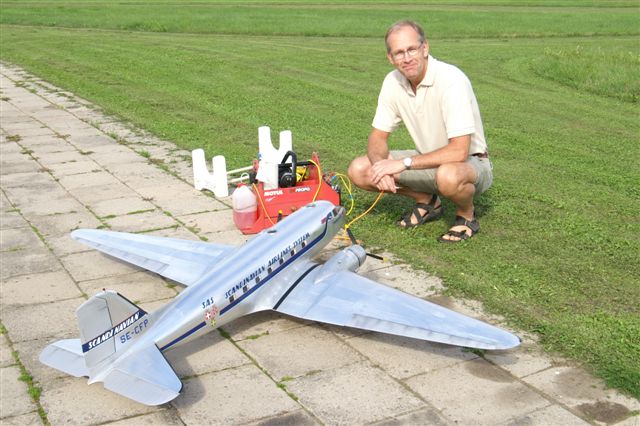

Hi!
I asked myself that question this summer when i was about to test fly my 26-27 year old Marutaka DC-3.
This airplane's fuselage is mostly covered in many small pieces of chrome Oracover and has Flite-Metal (or aluminum duct tape) on engine cowls, tail-cone and lower fin and on wing fillets.
The JR receiver (R 700)I used is mounted inside the fuselage with the antennae all inside the fuselage (it's not hanging out from the fuselage).
I checked how far I could walk with the transmitter fully collapsed, pointing at the model, many times before the first take off as I was a bit reluctant to weather it would work...but I had the same ground range as with all my other models (100m with antennae fully collapsed and pointing at the model) so the first flight went just fine and there hasn't been any range problem since either.
Weather a model fully covered in Flite -metal would have problem is something I really don't know.
Regards!
Jan K
