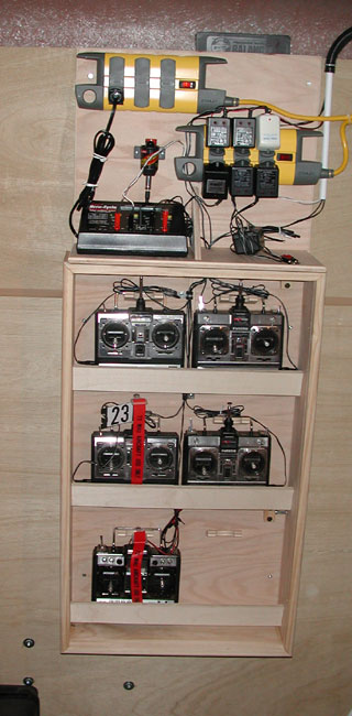

I just had to post one pic of this trailer in a separate post, sorry. I have looked at all the trailers in the ultimate trailer post and have to agree they are all fantastic. But since this is my brother and I have a personal attachment, I just have to show it off for him a little
He scratch built all the adjustable fuselage hangers - very very nice job.
Receivers all have there own little home behind a hinged lid with a plexi front.
The largest plane (so far) will go in the spot under the wings on the floor.
Two trickle chargers - one for the planes, one for the Tx's.
These are wired up to an all weather external 110 jack.
Radio Shack remote temp alarm - wired to go off in the house.
Heater and of course over head lights.
He will be able to go fly, clean everything up, put the planes and Tx's to bed, plug them all in, go home and park the trailer, and plug everything in at one time. Wake up refreshed and go fly
He's in the middle of the trickle charger conduit runs now.
Plans to mount a spare props rack, field box and fuel holders, etc., etc.
I AM SO JEALOUS

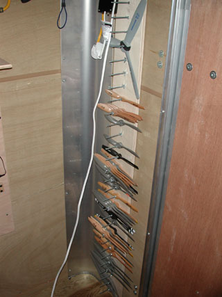

Finally had some time to get back to finishing up some things on the trailer. The transmitter rack is now complete... as is the prop rack.
Will try attaching some photos here...

Tried attaching multiple photos but that didn't work... here is one of the prop rack.
Charging rack in previous photo is set up so that (6) wall chargers can be plugged in at once and all trickle through a TME cycler feeding the power strip. The cords on the wall chargers are long enough to plug into the second power strip which is hooked up for constant charging. Each wall charger feeds (1) plane's transmitter and receiver. This way, all the planes and all the transmitters are charged in place and I just plug the trailer in when I get home.
The Hobbico AccuCycler is used to custom charge non-standard battery packs and I ran cables that are long enough to reach any fuselage or any of the transmitters.
Has been working great for the past couple of weeks, and as a bonus I've managed not to burn anything down!

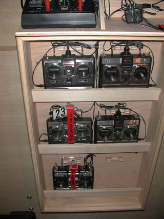

This one shows the entire charging set up. Next time I would try to buy charge strips where all outlets were in a single line... that way I could mount one high, one low and then just plug chargers into upper or lower outlet strip... would make the wiring much neater. But, these new Stanley power strips did look kind of neat so just decided to go ahead with them.

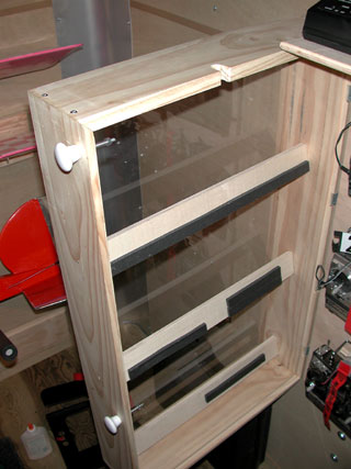

I built these two spring-loaded, pull-to-release latches to make sure the door couldn't fly open and send the transmitters on a wild ride. All of the wood that I cut and put together is held together by screws and glue so that it can't (fingers crossed) vibrate apart during trips.
If anyone is interested in pictures on how to do some of this stuff, please just let me know and I can provide some detail pics... may take me a couple of days to get to it, but I promise I'll get it done for you.
