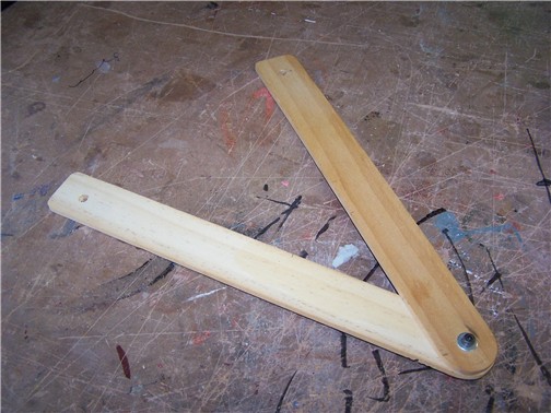

Old 12-19-2006 | 08:28 PM
build light's Avatar
Joined: Nov 2005
Posts: 2,246
From: Crete, NE
Default RE: Adjustable protractor to transfer angles from plans?
You can make one easily from popsicle sticks for near nothing! Or any two straight flat straightedges, metal, plastic or wood. jst match the angle and use a thumbsrew to hold them in plaace to keeping them from slipping, then just move them to where you need and presto! there you go!
So long as they do not slip or move the angle remains constant. You do not need any fancy graduated by degree tool though they are nice.
Look here, works great!
Robert
Old 12-25-2006 | 08:14 PM
Joined: Jul 2003
Posts: 2,261
From: Greensburg, LA
I'm with you. there so many tools that we can make ourselves and have a bundle of $$$ left for the big pile of balsa and CA that we need. the store bought one one may be fancier but doesn't do the job any better. dick
