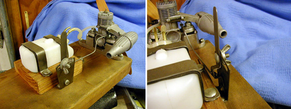

Default Engine test stand
Here's what I use for .049 through .60 size engines. It might accept larger glow fuel engines but .60 is the largest glow engine I've got.
It's made of scrap lumber (2 x 6 and 2 x 4), with an adjustable Tatone cast aluminum engine test stand bolted to the 2 x 6. The whole affair is tightened (using the 2 x 4) into my bench vise, which is located at the end of my work bench near my garage door. The 2 x 4 is bolted onto the bottom of the 2 x 6 with a single carriage bolt (up through the bottom) with a nut and washer on top to tighten down once I've selected the angle I want to set the stand at in relation to the vise/workbench/garage door. When running the engine, I pivot the test stand so the exhaust goes out the garage door. The tank is held on with sheet metal clamps with strips of tire inner tube rubber used as gaskets between the clamps and the tank. The clamps are just the right length so as not to put too much pressure on the plastic tank - the rubber gasket takes up the space so the straps don't cut into or deform the tank.
The little throttle-stop mechanism is something I designed and it works great to hold the throttle setting exactly where I want it. It's cut out of sheet metal and the two parts are mounted with a carriage bolt and wing nut. Operation should be self-explanatory.

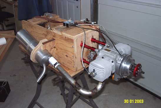

Old 01-30-2003 | 09:53 PM
Forgues Research's Avatar
My Feedback: (7)
Posts: 3,453
From: Glen Robertson, ON, CANADA
Here is my setup.
Old 01-31-2003 | 04:53 PM
Posts: 467
From: Fayetteville, NC
Aerographix, I like your stand but with that large engine, what keeps it from coming after you when you fire it up? The base appears to be a Workmate.....is it?
How do you fasten the base to the floor, or do you?
ljones5000
Old 01-31-2003 | 05:08 PM
My Feedback: (7)
Posts: 3,453
Default Re: Engine test stand
ljones5000
It is a workmate. I had it running yesterday at 1/4 throttle and I was hanging on for dear life, seriously, I will be installing a servo receiver to run it from a remote area, the air blast is too much for my face.
the whole thing will be tied down with ropes in my back yard, and yes with these mufflers, the noise is quite acceptable.

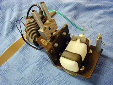

Although not the most visually appealing setup, sometimes the simplist solutions are the most effective...

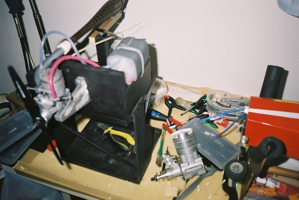

Old 02-19-2003 | 02:02 PM
Joined: Feb 2003
Posts: 44
From: Lenoir NC
here's a pic of one I saw on ebay........ I posted a question about this same subject on the "beginners" forum. If anyone has a test stand that they want to sell please let me know. Thanks

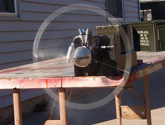

Old 02-23-2003 | 07:17 AM
mstroh3961's Avatar
Joined: Aug 2002
Posts: 1,828
From: Evans, CO
Default test stand
Here is mine. It was made out of 3/4 plywood, held together with wood glue, biscuits, and screws. Engine is a saito 91! I had to add the ammo cans full of lead to keep it from sliding the table down the driveway!
Regards

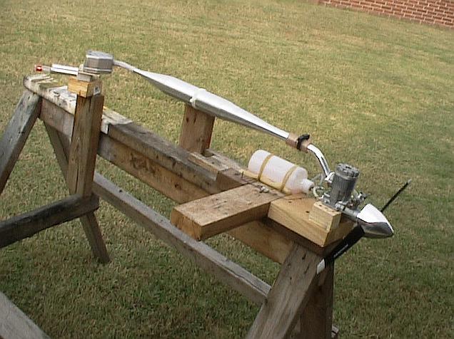

Mine are just a bunch of 2x4's and 2x6 blocks screwed onto my home-made sawhorse. It's amazing what contraptions you can come up with culled lumber, a circular saw and a drill driver.
Whatever you do though, it's important that you elevate the engine to the proper working height. It's also nice to build a stand that you can reposition depending on the prevailing wind direction. Nothing worse than having smoke blown all over yourself when breaking in a motor.
