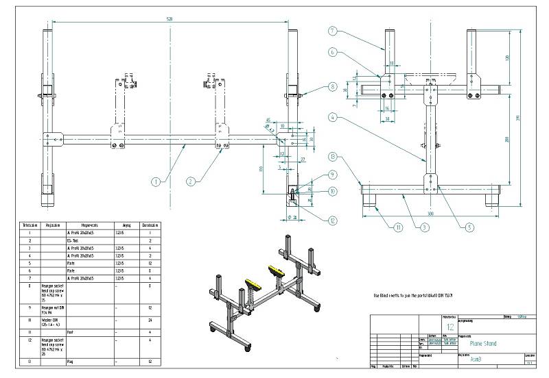

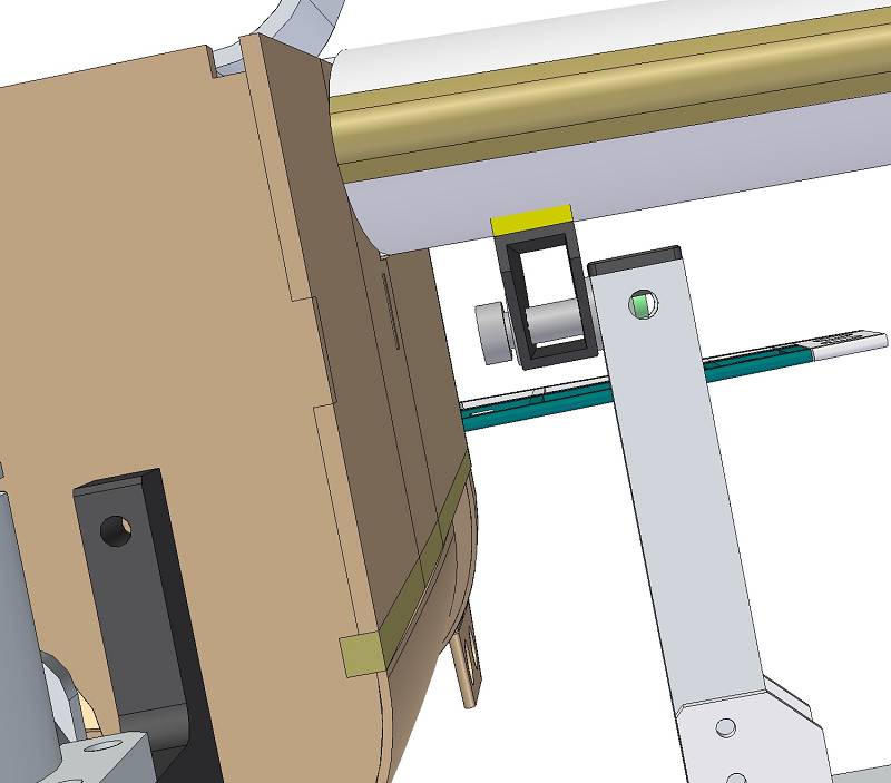

Hi
I have just finished my Al plane stand. I designed it for repairing insted of trasportation.
In the future i am going to rebuild it for transportation and for CG balancing too.
If anyone needs the plan I can send it in pdf.
The total cost is about 22 Euro so far.

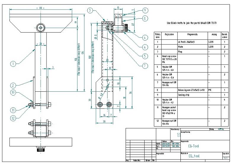

Posts: 22
From: Gyor, HUNGARY
Default RE: Plane Stand (Aluminium)
Hi
I finished the design of the CG-balancing tool. Today I made a test version and it works properly. It is sensitive and not that easy to use than I have expected, but it works.
I used rolled-shaped PVC as the balancing arm and fitted it with a dowel srew with some play between them.
The friction between the PVC and the steel is very low so it has just a small affection to the process.
I think the inaccuracy could not be more than 1mm.

im interested in the balancing tool. Do you just measure the distance manually then place the stand on that point? What are the dimensions?
Old 03-12-2007 | 03:47 AM
Attiqs's Avatar
Joined: Jan 2007
Posts: 22
From: Gyor, HUNGARY
Default RE: Plane Stand with CG balancing tool
Yes of course. I place the required CG point over the fulcrum of the CG-tool then comes the balancing.
The methode is similar like Great Planes's CG Machine. http://www.greatplanes.com/accys/gpmr2400.html
Now I am working on the drawings. After finishing I will send it to you.

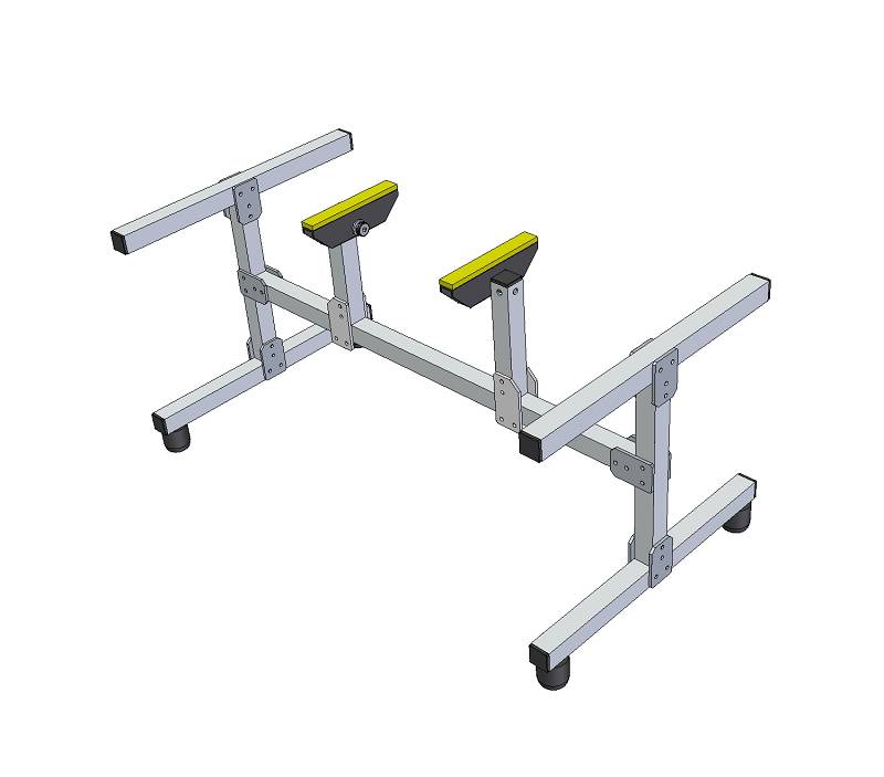

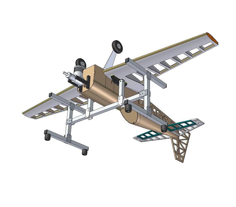

Attiqs's Avatar
Joined: Jan 2007
Posts: 22
From: Gyor, HUNGARY
I finished the last version of the Plane Stand + CG-tool. Here are the samples:

Villa's Avatar
Joined: Aug 2003
Posts: 2,057
From: Wilson, NC,
I just noticed something on the very detailed drawings, that may have some interst to those familiar with drafting and interpreting drawings. Unfortunately I cannot remember some of the drafting terms, so please bear with me. I refer to the post of ATTIQS dated 3-14-07. The first drawing shows a front view, a side view and a bottom view. Note that the side view shows the LEFT side of the front view, and that the bottom view shows the TOP view of the front view. In Europe the projection of the three basic drafting views ) front, side and top) is opposite to the convention used in the United States. On a simple drawing like shown this will not be noticed by most people and should not be a problem. On a more complex drawing you may get the feeling that your eyes are playing tricks on you because the drawing seems to be laterally reversing in your brain. Once you understand the two conventions you will have no problem. One convention, I believe, is called left-hand projection, and the other is called, I believe, right-hand projection.

Nice work! Glad that I have a aluminum recycler fairly close by to get some square tubing. Straight cuts, accurate holes, pop rivets - simple is a good thing.
Couple of questions. What tool did you use to create the pics in post 8 and 14? What format can be used to distribute "the plans"?
Thanks for sharing ...
Old 06-02-2010 | 01:30 AM
Attiqs's Avatar
Joined: Jan 2007
Posts: 22
From: Gyor, HUNGARY
Hi
I use Solid Edge to creat the plans.
I am going to sendthem soon.
Regards,
Attila
