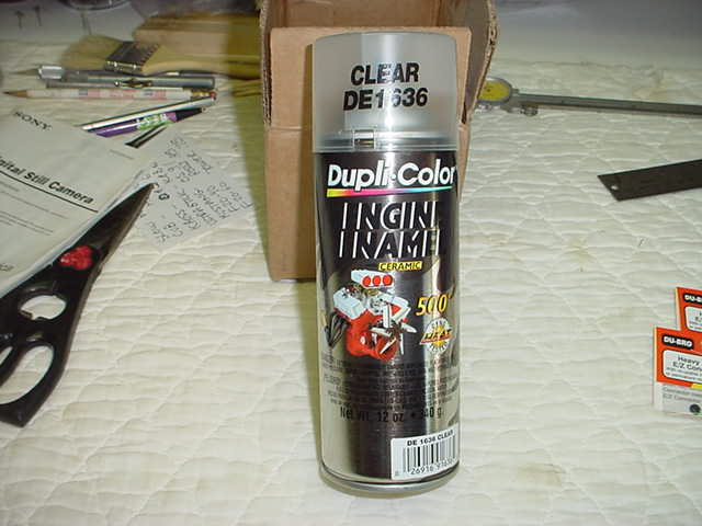

Auto Zone sells this enamel clear-cote spray that works
good....

flyboy dave , Is the clear fuelproof? Vic
Old 02-18-2003 | 06:05 AM
Flyboy Dave's Avatar
My Feedback: (21)
Posts: 13,864
Received 10 Likes on 10 Posts
From: Pinon Hills, CA
Default Glossy Fuel Proof Top Coat
Yep, and it's only like $3.79/can.....
sprays real nice, no splattering....drys fast and hard.

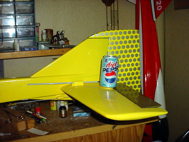

Old 02-18-2003 | 06:08 AM
My Feedback: (21)
Posts: 13,864
....looks ok to me....

I sprayed 4 mist coats of color, and came right in with the
clear....3 coats....10 mins apart....(no runs)
It only comes in basic colors, though.....

Flyboy Dave...Does the AutoZone clear stay crystal clear over white, or does it cause the white to appear yellowed like other one part clear coats?
Jim
Old 03-06-2003 | 12:12 AM
My Feedback: (21)
Posts: 13,864
Jim....I can't tell you....others have asked....I painted
the clear over YELLOW !!! :stupid:

Zabel....So far....the top-coat appears to be crystal
clear....with no signs of yellowing what so ever.
( Ed....if the plane turns orange, I'm in deep doo doo )
