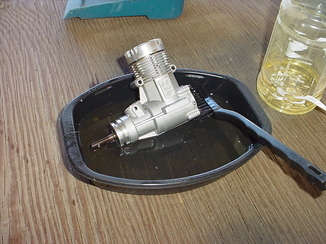

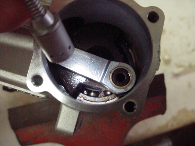

....yep, be sure to use the washer next time.
Those are good running engines. Check this clunker I got a few years back I looks
like the worst old neglected piece of junk on the Planet. It turned out, the engine is
in super primo shape....it just needed some TLC. I just cleaned it up a couple weeks
ago. It runs like a top, and looks mint.
The bearings were protected all those years by a coating of castor oil. No rust.
FBD.
