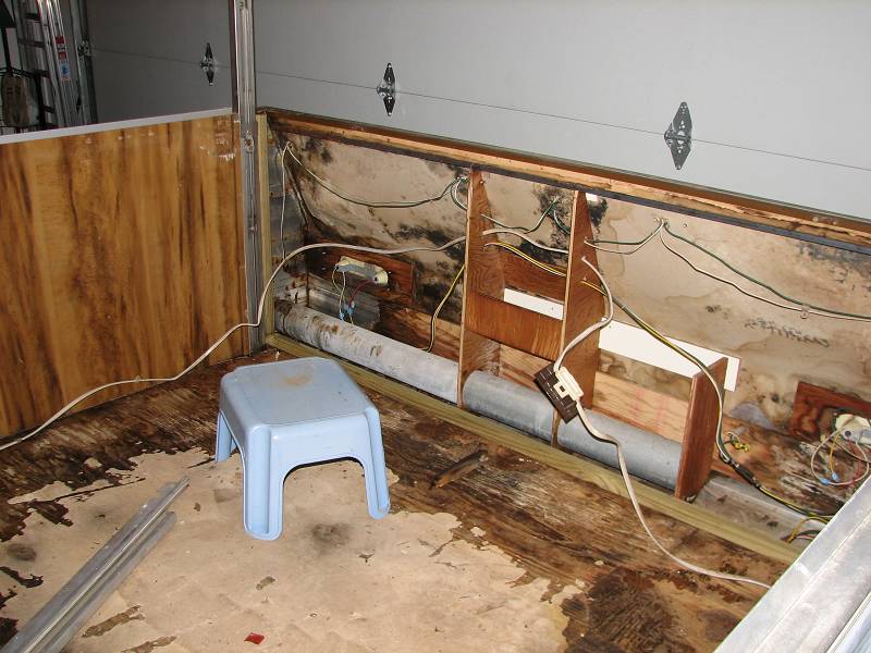

Got back in town tonight and went ahead with gutting the rest so I can get to the fun part... re-building it!! Here's the latest view. Yuck!! [:'(] The back panels were so bad I just ripped them out. I think the rest of the sidewalls are good enough to leave in place. If I can get a majority of the vinyl to come up I'm going to bleach down the floors and sidewalls (as well as the exposed back areas...) and do my best to dry it up. I need to get underneath and rip a bunch of tubing (gas/water) out so it won't fall off inconveniently on the road
... Also need to come up with a plan for re-routing the power lines... either behind side walls or maybe just down through the floor and back up so that they are out of the way or at least protect them with conduit or the like... not sure yet. I know I want them around! Having power already distributed around the trailer can't be bad!! [8D] Picked up a converter so I can plug the lighting up and test that whenever it's convenient. Also got 2 of the 3 cables I need to fix the lift mechanism and some lubrication for same. 3rd cable will be mailed to me soon. Still have the fridge and kept the counter top so may re-use those once I test to make sure the fridge works! Also planning on keeping the overhead lights and re-installing a switch to turn them on/off near the door so if I'm loading or unloading near dark I can see what I'm doing. Lots more stuff running through my brain... sealing up the lid so no more water!!! How/what type of storage to install... What sort of enclosure/where to hide the battery/inverter... etc... etc... etc...

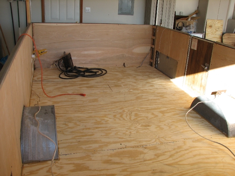

Well I have made a bit of progress today. Got a piece of ply cut and mounted - screwed and glued to the back "U" frame I built in rear of the trailer the other day. Also got the first piece of ply placed in the floor. The problem with that was because of the old wood rot/missing I didn't have enough left in places to get a proper bite and the new ply is not perfectly flat, nor would I expect it to naturally lay flat considering the weather extremes it's likely to see anyway!! My ingenious [&:] (I hope) solution was to glue the sides of the flooring to the old wall boards and rear 2x2 base to my frame and then add some temporary bracing that I will pull out tomorrow and hope for the best. If this doesn't seem to be totally effective I may go back (and have considered doing this anyway) and add some wood at each joint (like quarter round but probably will use something in the 1x1 - 2x2 range) and glue and screw that to really reinforce things.... we'll see. For now the next steps are going to be to finish the floor with ply and start working on the sidewalls with the Luan. Once it's all in, I'll seal all the joints with either silicon caulk or caulk-adhesive if I feel some strength is needed. I need to start making some covers for the lifters in each corner. There were hardwood blocks across these that seemed to actually be structural and maintain spacing so that the lifters didn't bind but some were in bad shape so I'll replace them all. Plus some ply/luan cut to size for "modesty covers" that I presume are just to keep things from getting into the tracks that don't belong there
I may just bond some Luan to some ply to make full length covers all in one piece with some hardwood strips glued on if I feel the strength is needed... Probably need some pics to explain properly so will do that when I get to that point. Anyway, here is where it sits for tonight. Looking forward to pulling the temporary bracing (wax paper underneath it to make sure it stays temporary!) and see how this is working out.
.I may just bond some Luan to some ply to make full length covers all in one piece with some hardwood strips glued on if I feel the strength is needed... Probably need some pics to explain properly so will do that when I get to that point. Anyway, here is where it sits for tonight. Looking forward to pulling the temporary bracing (wax paper underneath it to make sure it stays temporary!) and see how this is working out.

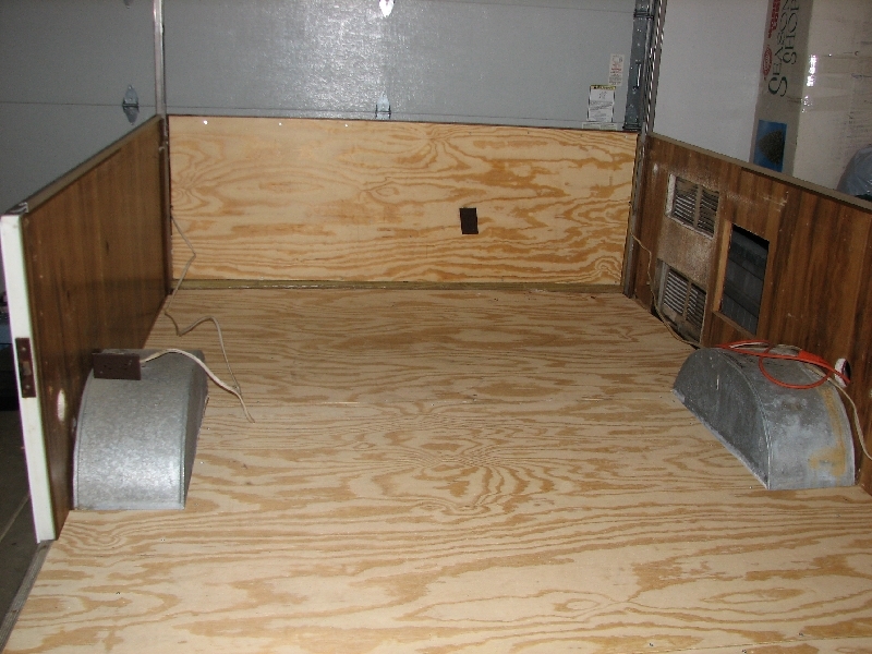

The floor is in and I think it is going to work out OK. My glue set up and is holding up well. I walked around the edges up against the glue joints and nothing moved.
The wood gives just a bit when you walk on the floor (not enough to see but it feels like it is somewhat cushioned) but much less than it did when I got the trailer and I think it will work out OK. Here are the pics at the current time. I need to start on the Luan for all the side walls next but my eyes are tired from all the measuring and cutting today so will put that off 'till tomorrow at least. If I do anything else tonight it will be to install the new marker lights, check the electrical, or something minor like that. Enough physical labor for one day! I knew there was a reason I went to college.
Probably should have patched all those little holes going through the floor before I laid the wood down but why start thinking ahead now [sm=wink_smile.gif].
I also need to do some caulking around the wheel wells and such but I'm thinking I may wait till I get all the lumber up and then go fill all the gaps at once right before I undercoat it all. Might need to install whatever cabinetry is going to be permanent before I do that as the gap between the sidewalls and the wheel wells varies widely when the walls wiggle around. Hopefully those will get stabilized when I get some of the sidewalls "Luan'd" and those cabinets in place.

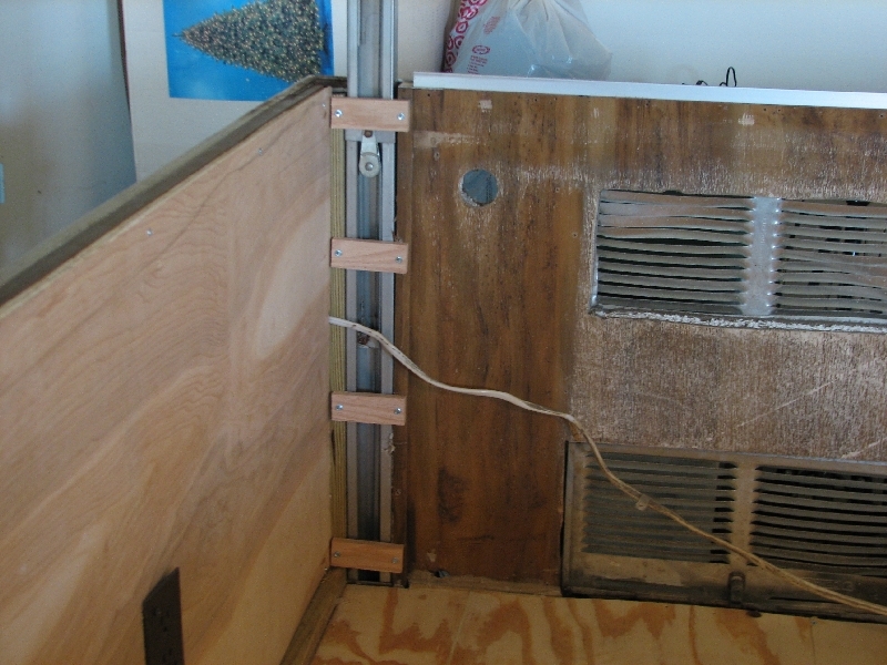

More progress today. Finished sheeting the right sidewall and installed new hardwood blocks to keep the lift mechanism in their pockets. Those little blocks also help stiffen up the hole structure so I bought some hardwood and created new ones for all 4 corners. They definitely make a big difference. Installed 3 sets and left the 4th for after I fix the lift cable on that corner. Here's a couple snaps of the results for today. Takes a while to do this (well for me anyway [&:]). I measure 3 times, cut once, trial fit, cut again and repeat... I always cheat a little toward to big and sure enough it is! I've never figured out how to stretch lumber though so beats cutting to short I guess. Still debating on how much storage I will need and how much I need just to help reinforce the sidewalls! Bolar had a good point when he mentioned how weak they are without the internal structures to hold them up. I'm pretty settled on a 24"wx36"lx18"h structure front left to hold the battery, inverter/charger system. That will hold all the stuff and have some extra room for storage and whatnot. Might event put drawer back in right above it so might be more like 24" high. Front right I need to do something because that is the weakest wall plus it has that external access hatch that might be handy. The opening is about 12" tall by 30" long. Might just build a box about 18" or wide and install that... maybe without a top so access is handy from inside as well... or maybe with a true lid that can be opened. Back right I plan on re-installing most of the countertop that was here. I can see setting a plane on it and then climbing in the trailer and grabbing it to sit it down on the floor. Leaning over the wall to do this is a stretch for me. If I put the counter in just an inch or two below the top of those walls and maybe put a slight lip around it... I think it will come in handy for a lot of things. Underneath could be left open or partly enclosed for storage... Maybe a spot for pop-up under there?? Partly will have to be determined by the need for support of the top. Certainly that will make the wall on that side stiffen up.

Got back on it today and first order of business was to pull the bad lift arm and recable it. I found it interesting that there is nothing that really holds those things down except the cross brace at top interfering with the pulley. Guess there's really no need for anything considering the whole weight of the top holds it down and they sit right on a frame member below. Here's a pic with the lift mechanism removed. Just a framed up wood socket really. Got the internal cable connected and routed the one from under the trailer up into the lift mechanism. Need to attach the final cable to the winch and I'll be back in business on the pop-up part of trailer.
After lunch I wnet back to work on the interior walls and flooring. Added a little glue where there are gaps or edge to edge corners where there is nothing to screw to and will let it dry for tonight. Feels good to get that taken care of. Now I can start working on counter top... storage cabinets and the like. Making progress! [8D]
Also spent a little time underneath and pulled all the remaining copper gas lines and took a quick peek at the winch mechanism. Looks like it might be a bear to get that cable hooked up where it belongs as access is limited and the old cable looks like it's balled up around things in the winch. I'm thinking of jacking up the whole rear end and putting the thing on some jack stands to give me some more clearance to work on it and see if I can get in there and get rid of the old cable first. I'll try to get pics if I get some space to work!

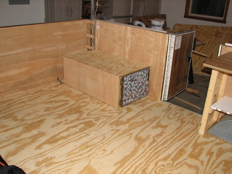

Hi all,
Took a break on this while my sister-in-law had open heart surgery... two valves replaced etc... She's doing great, just went home today. Anyway, I got some time to work on the trailer today. Got to work re-installing some of the counter along the right side and also the externally accessible storage box was re-built. These structures helped stiffen up the sides and I did my best to get everything as square as possible and I feel like that worked out pretty well since the door and outside hatch to the storage area seem to open and close smoothly now and the whole trailer feels much stiffer.

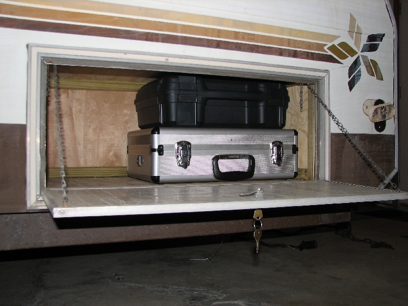

I need to finish up the storage box as you can see in this first picture. Probably will re-install the door on the end that allows access from that direction as well and not sure yet if the sides will just enclose it or if I'll build them up a bit higher so that I can use the top as a tray/shelf for stowing transmitter boxes or other items... I don't intend it as a seat anyway so might just as well use that space for something! Also will probably finish enclosing the wheel well under the counter with a front panel so as to make it neater and give me a place to mount the AC outlet over there. It's just hanging at the moment.
One more "box" to build on the left front to house the battery/inverter/cord plus I'll probably build a cabinet around the other wheel well as they are kinda flimsy and if someone put their weight on it I think it would dent badly and possible interfere with the wheel... that would be bad. [&:] Also picked up some plastic race/conduit stuff to hide the wires on the other wall and protect them from damage. Will wait to install that 'till all the rest of the construction is done inside... right before undercoating starts.

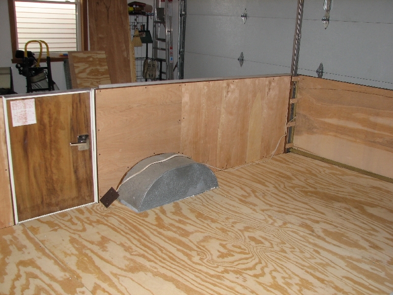

Made another push on the interior today. First two photos show the new power center in the front RH corner. Top is easily lifted off to service fuses, battery etc... The battery box has a hole out the bottom (just like when it was a camper) and a vent out the sidewall to allow for airflow during charging. Need a new vent hose and have to sort out the battery hold down but otherwise this is looking pretty good. Next two shot show the new radio storage box in the front right corner of the trailer. there is a door on the back to access things from inside or you can come in from the outside. Things are a bit tight but I can get two radios, in their cases in plus some excess space that I'm sure I'll find a use for! I figure if I need access to anything without cranking up the lid it will be the radios as I might just want to grab an electric from the garage and throw in the back of the car or truck and head out if time is tight or whatever. Especially since that hatch is lockable, it seems like a good spot for the expensive stuff! Next is a shot down the left side showing off the new "plastic conduit" to neaten up and protect the wiring running down that wall. Finallyis a pic showing the outlet under the counter mounted and the wires hidden up underneath. There's still a long list of items on the todo list but today I actually feel like I am starting to see what it will look like and I'm pretty happy so far [8D]. Won't be long and I'll have to do a bit of finish sanding on some corners, caulking and paint, carpet etc... etc....

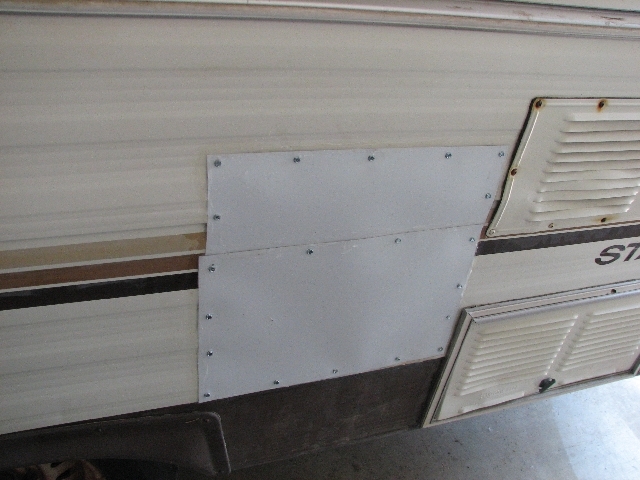

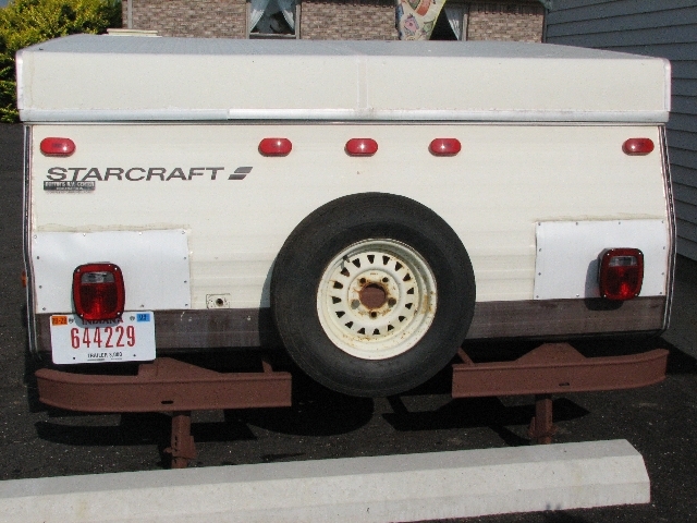

Little by little I'm making some more progress... Here are some new pics showing how I patched over all the holes left behind by appliances etc... Also wire-brushed and did some rustoleum undercoat on all the bumpers tongue and spare bracket etc... I had planned on painting black on all of that but now not so sure. I'll either just go a second coat with the undercoat or find a nice brown as the undercoat color is actually a better match than I think black would be! You may also notice I completely replaced the safety chains that were really corroded (not much use if they won't hold in a pinch) and put a new wheel on the jack so it would roll much better than it did. That was a bit of an adventure as I had trouble finding a wheel the right size and able to handle the load without immediately developing a flat spot, etc... but I think I have a workable solution now. Seems to work fine. I'll keep updating. Hoping to do some more calking this afternoon and hopefully start on some more interior work soon.

Well, frustration with not having a trailer has finally overridden all else and I've been making time to work on the trailer again[&:]. Since I last posted I have done several of the remaining "necessary" projects and decided to postpone those that can wait in favor of what's necessary to make it workable. If I don't get my planes out of the way of the work in the shop soon I'll destroy them all just trying to get around.
So I have replaced the taillights, all 5 amber markers (all of them were so brittle you couldn't open the covers to replace a bulb) and re-wired the lighting connection to the vehicle up front to something that was made this decade and can be matched up! Inverter/charger is non-functional [
