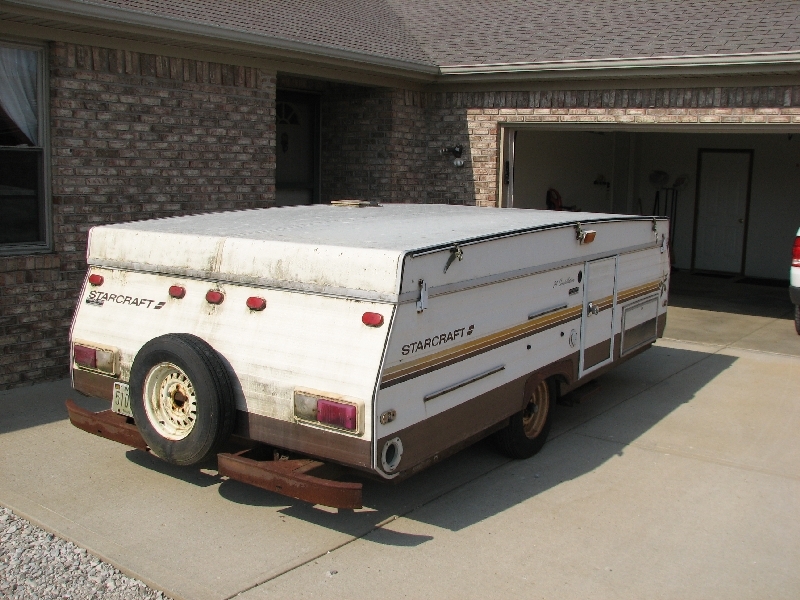

Well here is the '84 Starcraft I bought to become my new airplane hauler! I'll try to post pictures and updates occaisonally and would welcome any questions or suggestions. Since these pictures (if I'm uploading them correctly, we'll see) I have washed the whole thing down on the outside with a bleach based cleaner to remove all the green mildew and make it where you don't get dirty just walking past! I also have taken out all the canvas and cushions etc. and had a nice bonfire. It smells better and now I'm ready to start tearing out the rest of the interior. Also have one corner where the lift mechanism has snapped a cable. Am working on investigating and getting parts to fix that but that can wait a bit while I get started on gutting the interior. Also have a few marker lights that have no lenses and need to test the lighting (which will require a new plug to match my tow vehicle). Anyway I'm just getting started.

Good Luck. I have a fellow club member that has converted one nearly identical to yours. As you said, he cleaned out the interior, carpeted it and he can store a lot of planes and related equipment in there.
Install a 12V car battery and wire it so you can run your chargers, etc. off of it. Add some parts bins and you will be in RC heaven.
Definitely install a separate 12v deep cycle battery for it. Interior lighting and 12v power tools can be run off it. Fix yourself a small workbench in there, too.

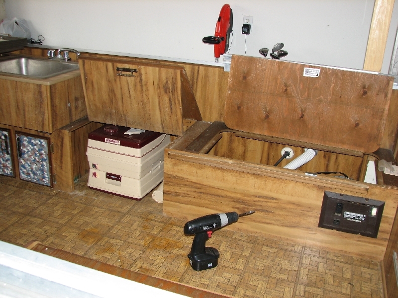

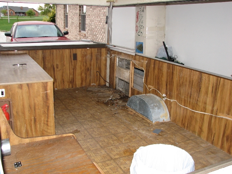

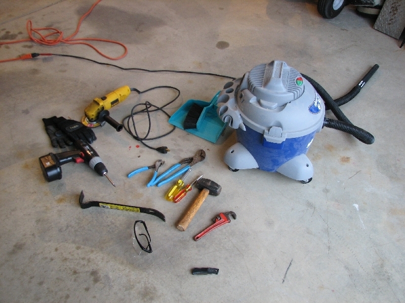

Here are some pics from today... Spent another 1.5-2hrs starting the tear out. Here is a view of the left (front of the trailer is to the right) side interior before I started. In the front-most storage area is the electrical supply including (apparently) a battery, inverter and access to a plug that allows for powering off of AC. Also a vent setup so that the battery (perhaps anytime the trailer is plugged in??) can charge and vent fumes safely! I think I'll be keeping that stuff intact but may relocate it or build a new enclosure for it....
Joined: Oct 2004
Posts: 127
From: Fairland,
IN
Here is the same area several minutes later without the cabinet (1st pic).... Then working on down the side the sink was next... pretty easy, just unscrew some wingnuts to pull the sink and disconnect some flexible tubing. A few hundred screws and a bit of hammering later and that's done. Next is the worst so far... the heater/water heater. Yikes!!! Cut this connection, disconnect that etc... etc... etc.. and then take the outside vent off and pull it out that way... Then take all the screws around the outside off.... and find that two of the screws are rusted [:@] so time for the grinder!!! That got it to move, but wait, you can't with that gray cardboard (heavy duty) shield around it so tear part of that off too [>:]!!! That did it... watch out for the water draining out the bottom all over your shoes
Now there's a big hole but at least the big monster is gone... next the fridge.

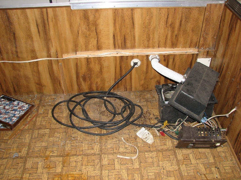

The fridge comes out pretty easy just some electrical and hoses. DON'T do it like I did and pull apart all the cabinets to get at it... [&:]there's another of those outside vents that will get you easy access to the back. Once the connects are off and you unscrew a dozen more screws around the front it slides right out and it's pretty light too! That water tank you can see beyond is easy as well. Just unscrew the outside fill and drains and pull off the hoses and it slides right out! That one I got right in one!!

So here is the end result for today! Got a few water and gas tubes to get underneath and remove and some electrical connects I want to trace back and either cap or remove entirely (trying to keep the electrical working when it's all over). Probably will re-route the big heavy electrical wiring still hanging on the wall before it's all over just to keep it safe and out of the way but it's OK for now. Final shot to show all the tools I've used so far. Nothing to complicated needed so far and the battery operated drill/screwdriver has gotten the biggest workout. I probably took out 150 screws today!!! Dont' want to rip this stuff out using a sledgehammer and create any new damage I'll have to fix later.

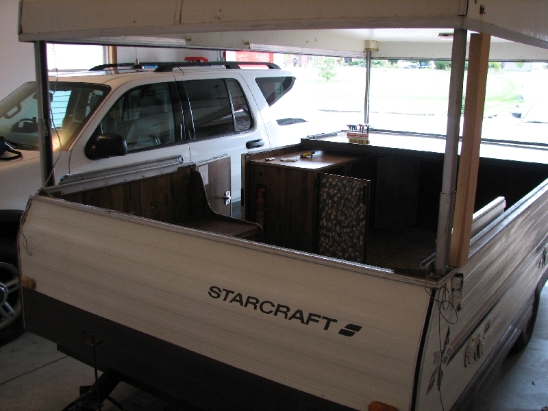

Anyhow there was good news and bad news today. First the good news. I decided to tackle taking the bunks out. Here's where I started (Pic 1) It looked I was going to have to take out 4 bolts on each side that would allow each of the successive telescoping sections to come out... I decided to start with the one closest to the body of the trailer. I pulled out the slide far enough to line up the hole in the slide (You can see the whole on the back of the rail in Pic 2) with the head of the bolt (which turned out to be an allen bolt... unlike everything else I'd seen so far!) and unscrewed one one on each side. Holey-Moley!! That was all it took. 5 minutes later and I was here (pic 3).
Five more minutes and I had both out! That was sweet
