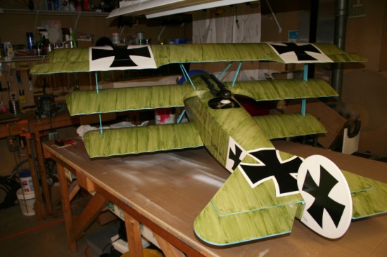

I love Solartex! Less work but not as good as Sig Koverall in my opinion. I used Solartex on these two planes painted with Acrylic Latex hobby paint and overcoated with Oil Based Satin Polyurethane Minwax. Great combo just watch the light colors as the Poly will yellow with time.
JEB
