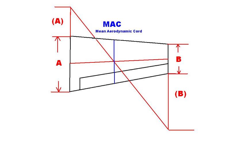

CG is usually measured as a % of MAC ( Mean Aerodynamic Cord), the MAC of a wing can be figured out by squaring the wing as depicted in enclosed drawing. Once you have your MAC it is just a matter of deciding what % is desired for CG. On a aerobatic mono-wing airplane 28-30% is a good place to start.

This is what I was trying to explain. Every magazine seems to have an article on the MAC calculation every couple of years. But if you understand the principle -- the point on the wing where there will be equal areas on both sides, then and it's easy to estimate. In fact, for most planes it is completely unnecessary because they have constant chord wings.
But if you do the MAC calculation, then you STILL have to decide where the CG should be. So then after all the measuring and calculation...people tell you to guess! I'm not trying to be critical of anyone posting here. It's something I have seen over and over.
Of course, guessing works well enough, especially a conservative guess -- the airplane will fly. But the CG is likely to be well forward of the optimal point. Then you've got to start experimenting with moving the CG back. Why not calculate a reasonable CG in the first place and set up your plane that way? It saves a lot of effort later on.

There is no perfect CG for everybody. Even with what I posted above, it usually take me numberous flights in order to get my airplane trimmed and CG'd the way I like it. I continually move the CG aft until the airplane gets very pitch sensitive and then move it slightly forward from there. That is why I agree with the guys above, to not waste any money on a CG machine and just use your fingers under the wing or at the wing-tip to get the CG set within the acceptable limits and then fly/adjust as required for your flying style. Once my CG is adjusted for my flying style I couldn't care less where it is, just how the airplane flies.
