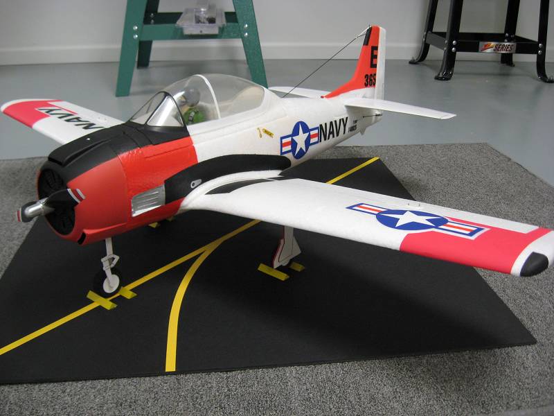

I have now coiled the antenna in this (electric) Parkzone T-28 and performed my standard range check which is to walk out at least 50 paces (100') with the collapsed Tx antenna pointed at the tail of the airplane and checked controls with motor off and then motor on. I've been flying this airplane since new (March) with no range problems yet.
