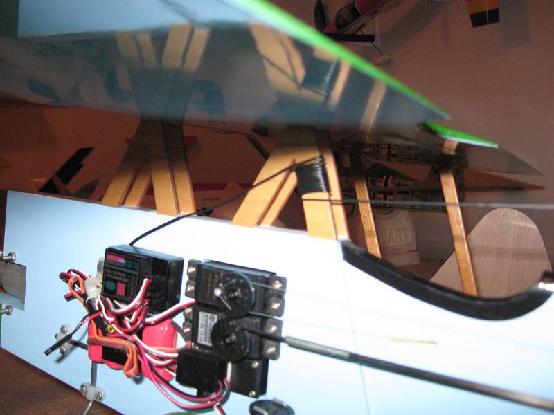

Can I do this to a Futaba 7-channel 72 MHz FM receiver and still have decent range?

I wouldn't recommend it. The receiver needs to have the antenna extended to its full length to receive signals of a strength to allow reliable operation. Shortening the antenna like that will cause problems. Why not run it in a soda straw (or something similar) inside of the fuselage if you just want to hide it?

I concur, that coil you created will change the tuning of the ant. Stretch it out to it's fullest lenght. however, if you are only flying it indoors, do a range check and if OK, fly it like that. Just set it down and move to the other side of the room the longest distance from the plane and see if you still have control. I would not fly it that way out side though.

This asking for trouble. When you coil up an antenna like that you reduce it's overall length, thus reducing the range.

The receiver in the picture is a Hitec 555 that I've been flying in that configuration without difficulty for several years. The coil is stacked and at no point does the antenna cross over itself. I was wondering if anybody had done the same with a Futaba Rx and had similar success.

I have done similar with a few different reciever, though I keep at least 1/4" between the wires in the coil, usually wrapped around a piece of cardboard or foam that can be taped to an inside wall. Especially useful for using JR radios in park flyers... (man those jr antennas are long) But done in a couple gas planes with really long range checks and no problems.

We have been doing it for years in the limited space inside a Pylon Racer. Usually wrapped around a dog bone shaped piece of balsa or cardboard.
Important that the antenna coil does not overlap anywhere.

A whip antenna http://www3.towerhobbies.com/cgi-bin...?&I=LXKX47&P=7 makes for a neat installation. It keeps everything confined in the fuselage with no significant loss of range.

Yes, you can do this without significant loss of range. Just make sure the wires don't cross (as you said) and I prefer to have them not touch each other as well.
It works very well.

Ditto. Don't cross the wires... I've never had a problem coiling like that. Do a really good range check and call it a day.
As long as you get a good range check you should be fine.

Anytime you coil wire induction happens! Unless the coils are spaced far enough apart, (how far I don't know) it will change the electrical length of the wire. (resistance) This changes the "tuning" of a reciever. It's the wave-length/electrical-length of the antenna that is critical to the tuning of the reciever. Crossing the coils probably wouldn't make much differance as its still going to be out of tune, though probably not as much. SWR (standing wave reflected) on a transmitter is critical. Thats why some trans. antennas are longer than others. Recievers are "tuned" to a specific frequency and the antennas electrical length is part of it. Change the electrical length with wire cutters or any type of coil, and ya change the frequency. This can't be a good thing even if it works close in! It will cut down on the range. How much depends on how far off frequency it is in a reciever, or how much of the signal is reflected back into the transmitter. Any of ya into amateur radio, or CB will tell ya that 1/4" of antenna length will change everything in recieving or transmitting. A wad (not a coil) of antenna wire inside of the fuse. with a little strung outside is WAY better than any kinda coil. Thats why that "whip" is the best alternative, when the rest of the antenna is waded-up in a hap-hazzard fassion inside the fuse. No coil, no cut! JMO. Q.
Edit; a "wad" of wire ain't a "coil", and does not change the electrical length of the wire. IF the "whip" has a load-coil then the reciever can be fooled to think the overall length is correct because the electrical length is correct due to induction in the coil.
My point is...wad it up inside, pull some out to fit the model and forget it.

If you give it a good range check (truly as far as you intend to fly) then you can get by with it. You will suffer a range loss relative to a properly mounted antenna, at least 50% or more. Check out rc-cam's web site for some good info on how antenna changes effect range. Even the best designed shortened whip or best engineered coiling will positively reduce the range over what a normal installation will have.

Yes a whip antenna does slightly shorten the range, but not significantly. Plus it's tuned and provides consistent results, it's a known quantity. Wadding and coiling is not tuned and is an unknown quantity. One installation might work fine for you and another might have problems.
I've been using base loaded whip antennas for years. A range check with the transmitter antenna down will show a few paces less range, but it's still plenty for flying and is safe and consistent from one installation to the next. Whip antennas are inexpensive, easy to install and reliable.

If you want some good info on antenna effects check out http://www.rc-cam.com/ant_exp.htm. You will see that even the best shortened whip will cause an 8 db loss. Remember, the range is decreased by half for every 6 db loss in signal strength.
