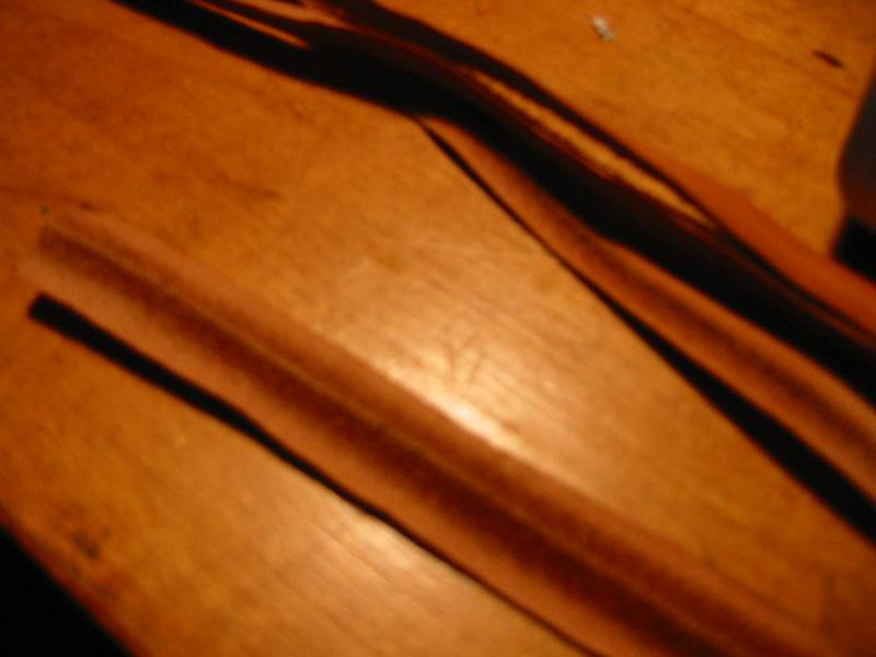

Have you ever tried Leather Fillets? Old control line stunt model makers trick.
Bill Sawyer sells them and he can be found on the Stuka Stunt Works forum. They come in many different sizes (widths) and they CA in place. You just buy them buy the foot. They're like belt leather only they've been cut to fit in a corner.
They work EXCELLENT and you can paint them.
ID:	900331   Click image for larger version

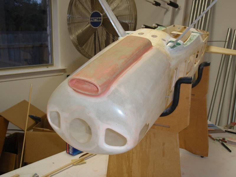

Here is a cowl modification using the green foam method.
ID:	906181   Click image for larger version

Default RE: Using foam for fillet
Texan, thanks for the insight i have been working on a waco making fiberglass parts is a trick
to learn. I just made a tool box door with working latch, my question is when you fiberglass
over the green foam does the fiberglass eat up the foam?
Old 03-18-2008 | 08:17 PM
Texan's Avatar
My Feedback: (10)
Posts: 568
From: Georgetown, TX
Roger,
I am very pleased to say that green floral foam is not eaten by regular thin (ZAP) CA, kicker, or epoxy. It has proven to be very easy to work with.
