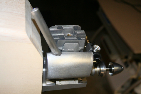

I am using some aluminum 2024T6 and 6061 left over from a homebuilt full scale build. I used JB Weld to "glue" the parts together. I have read a lot about using this high temp epoxy and glowing results. We shall see. Other, and I am sure better option is to weld. Without the equipment and skill this would be expensive though. I have not tried the high temperature aluminum solder. Might be an option.

After drilling the holes and cutting the opening I used JB Weld to glue blind nuts to the inside of the muffler. Went to Sears Hardware and purchased some Stainless Steel through bolts, washers and lockwashers.

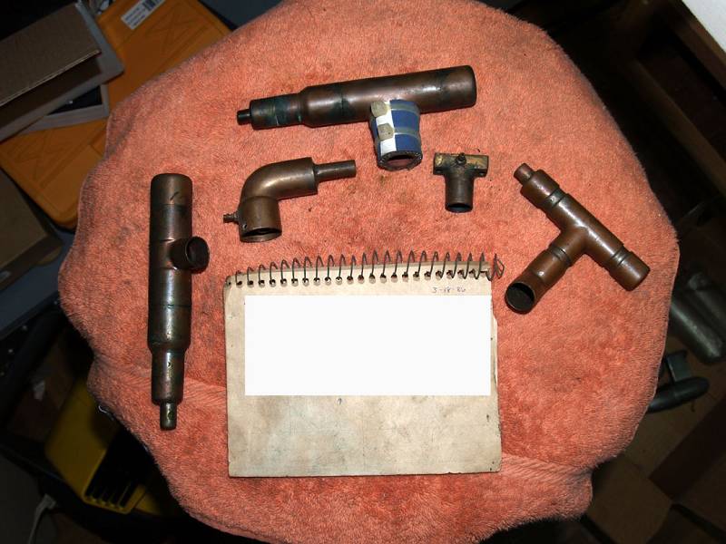

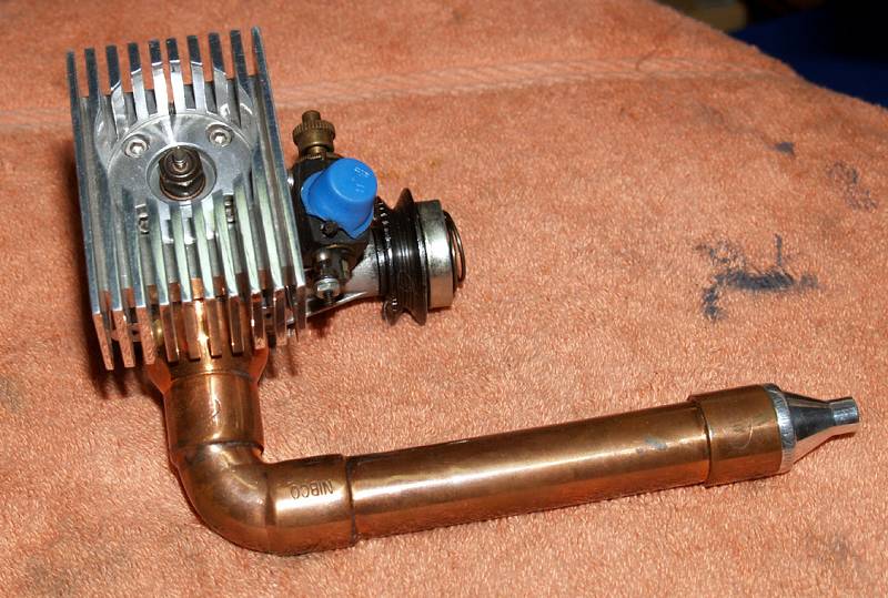

If weight is not an issue, you can use copper pipe fittings from the local hardware store and easily solder them together.
