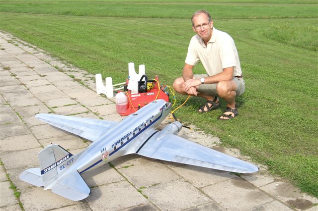

ORIGINAL: TLH101
Try balancing this on your fingertips. We used the Vanessa Rig to balance it perfectly.
ORIGINAL: jaka
Hi!
What's the fuss with all these strings and gadgest when you can just use your indexfingers!
Hi!
If your model is too big and heavy for ypur fingertips, suggest using a ruler and a weighing scale, then calculate using the 2 equations and 2 variables method, thus:
Lets assume that that Connie weighs 25 pounds and the distance between the main landing gears and nose wheel is 24 inches. Also assume that the weight on the nose wheel is 5 pounds, and the weight on the two main wheels is 20 pounds. Then:
let x = distance from nose wheel to CG
let y = distance from main wheels to CG
equation 1 is x + y = 24 inches
equation 2 is 5x = 20y so we will write this another way x = 20y/5 and x = 4y
substuting eq. 2 into eq.1 we have 4y + y = 24 inches or 5y = 24inches
so y = 24/5 inches which is 4.8 inches forward of the main wheels to the CG
and from eq 1 x = 24 - 4.8 or 19.2 inches aft of the nose wheel to the CG
feihu

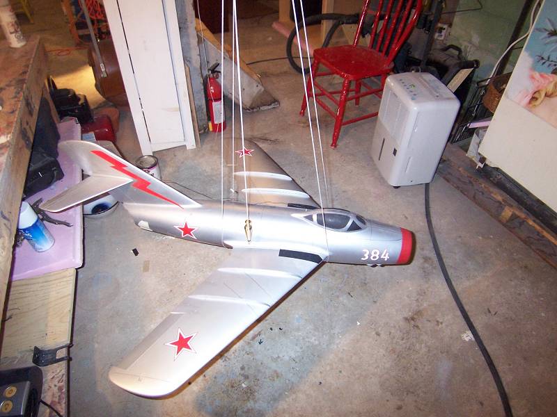

I'm not experienced with swept back wings, nor with jets, but the photos look like the plumb bob is pointing pretty close to 1/3 of the aerodynamic chord, so it doesn't look all that tailheavy to me. Do you have a recommended CG from somewhere? And how does the plumb bob indication relate to that recommendation?
