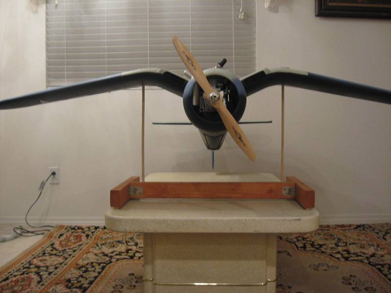

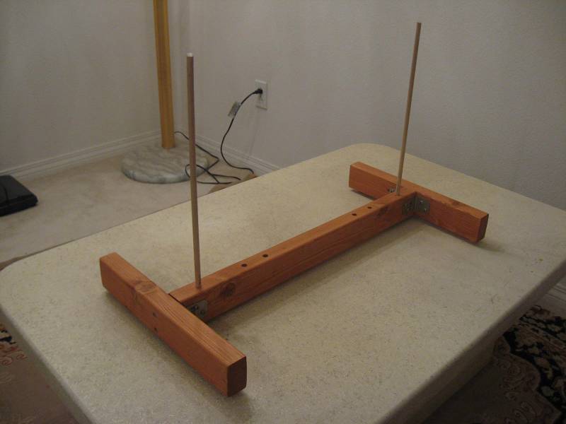

hi, I think this CG device is amazing. I cannot wait to make one. It took me a while to understand how it worked. Is there such a device to balance side to side? One question. If the plane is level and the plumb bob is at the planes suggested CG point, then the planes CG has been validated? thanks
Old 01-16-2009 | 10:30 AM
  #60
Banned
Posts: 2,670
From: San Diego, CA
Default RE: Vanessa c.g. Rig: How to.
That is correct.
Les

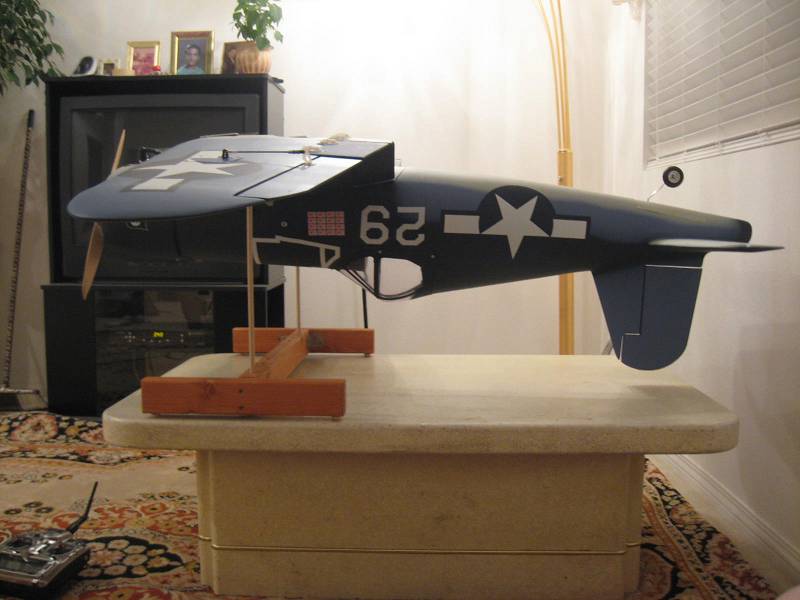

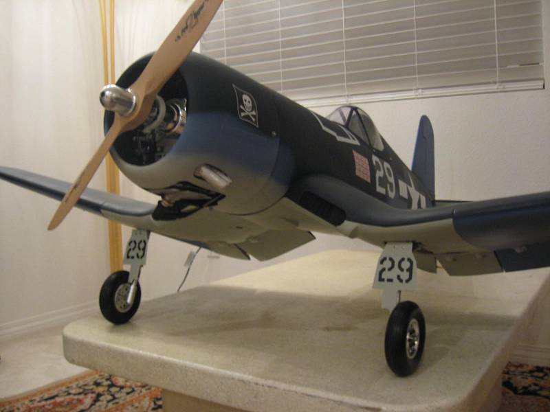

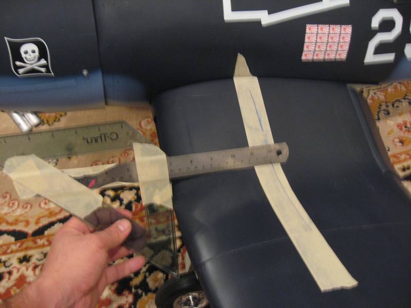

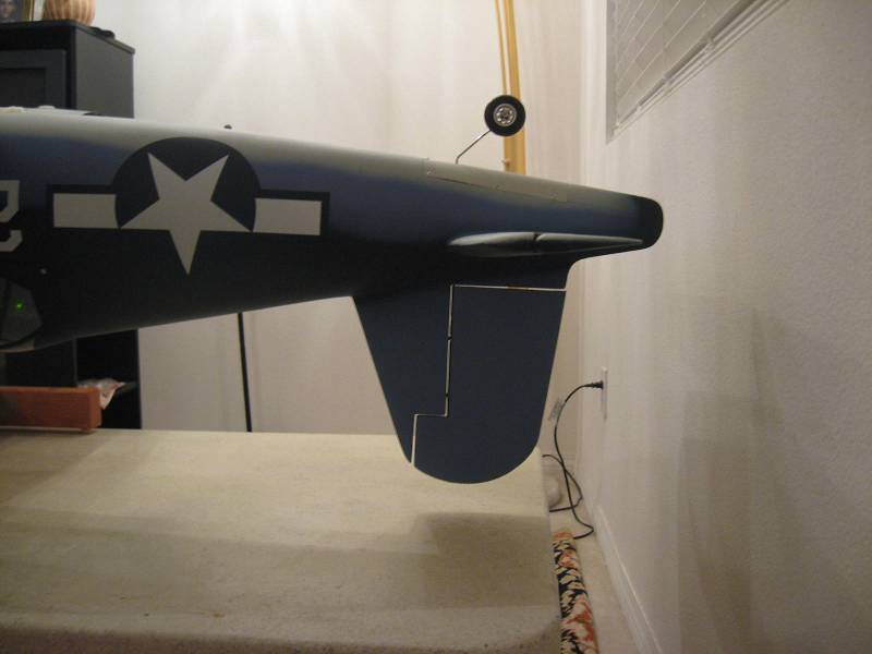

Hey guys I have a question, I'm trying to be certain that I am properly setting the C.G. on this KMP Corsair that I have just completed, I need opinions please (help!) My concern is that I may be off and wonder if you would suggest a vanessa for this job. The manual calls for C.G. at 130mm aft of the leading edge. I have always balanced my planes with the two dowel method so by going with what i'm used to, I made an amped up version to try and balance this Corsair at the curve of the gull wing. I have it sitting inverted such that when the model is on its called for factory c.g. point, the chord of the horizontal stab will be at 0 degrees to the floor or that is parallel with the floor. What feels disconcerting to me is that when I look at the model balanced on its called for C.G. and the Hori. Stab flat with the floor the fueslage in general appears as if its tail heavy(tail low). Perhaps this is just due to the shape and geometry of the Corsair but its enough to have me concerned. Here are images of how it looks on its factory called for 130mm cg and notice the overall appearance of the fuse relative to the surface of the table (appears tail low). I'm just worried if i'm possibly missing something here and have possibly a tail heavy condition. Any help and input will help me out a lot and I thank you in advance.
Louis
BTW: I measured the Main wing chord length at the root and got roughly 400 MM. So with the factory specified 130 MM c.g. point that I set the balancing line with on the tape, this came out to a 32.5% of max chord length. is this acceptable?

Louis,
I think you are being deceived by the shape of the fuselage. The Wing, Stab and thrust line of the plane all appear to be level. I would think that plane is about right.

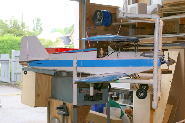

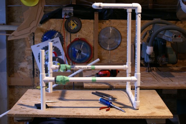

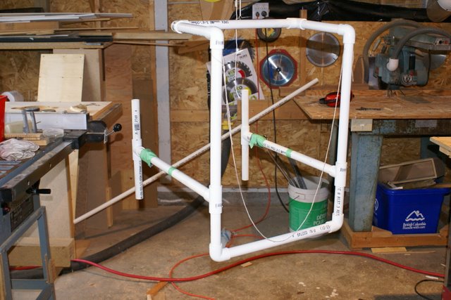

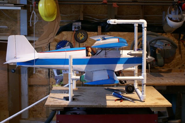

I have made and used the Vanessa jig for a few months now and find it works. It also served to get me interested in some kind of jig that I could just set a plane in and check the balance. I am probably being excessive. I first made a 2 "U" shaped pcs. from some 3/8's ply with one leg of the U about a 3rd of the other and then connected the two pcs with dowel and hung it from a string and set my electric model on it after balancing the jig and marking the cg of the jig. It appeared to work. So then I purchase some 3/4" pvc and some fittings and started cutting and glueing etc. etc. until I came up with this jig.
The first pic is of the jig on my mobile bench with the back legs and safety uprights on, the back uprights are removable and are to keep the plane from sliding off, they are removed to place the plane in the jig. I have marked the same point "cg" of suspension on both lower legs and for the purpose of trying it out one inch forward of this to accommodate my old bipe. The next pic is the jig by itself balanced by itself with the lower legs lined up with a level horizontal surface and then the third is with an old Aeromaster bipe with the front edge of the lower wing placed on the one inch mark and a string tied over the aft part of the fuse to hold it in proper flying attitude. The jig flexes, when suspended. as expected in the fourth picture but I think this is of little importance and something I could fix if it is. I originally determined to use larger dia. pvc to avoid this but it was not available. My intention is to put a leveling bubble on the horizontal leg for accuracy.
The whole thing with the plane installed and suspended seems very stable and appears to work although I question whether it is sensitive enough. It doesn't compare to the Vanessa rig for cost and ease of storage but the ability to place a plane in it and hang it and then add weight to see the results is interesting. I can see hanging a plumb bob for more accuracy from the upper support.
I'm really looking for feed back about the design and logic used. It has been fun and interesting so far and accommodates my one giant scale gas as well. The dimensions are approximately: width 15" height 20" without the legs [img][/img]and length 20".

I think the rig is great.balancing a plane can never be excessive .I have learned after several decades of flying that even the most complex plane flies rather easily if properly balanced .I balance both foward and lateral.my last maiden flight required 2 clicks of up and thats it.I also use the mac formula to find the CG but your jig would be a backsaver especially with big planes.
