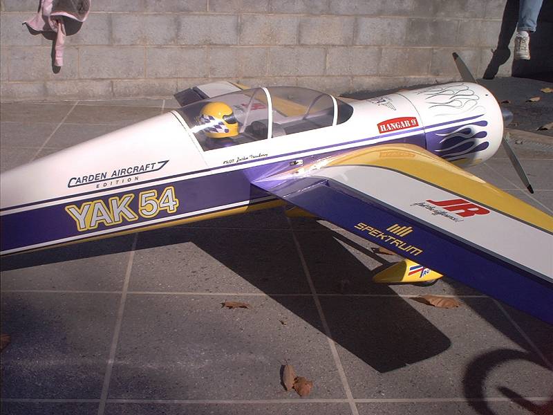

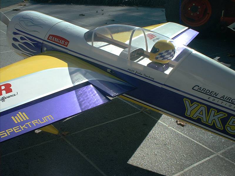

Kirby's Custom Graphics. They do great work. Prices are not bad.
