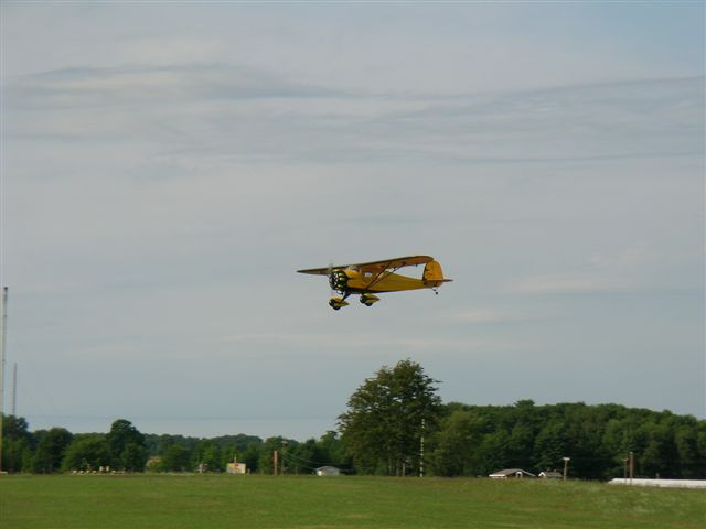

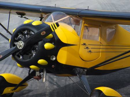

I frequently spray Krylon over 21st Century fabric. I just mask, sand with 400 grit, and spray.
The pictured MonoCoupe is over ten years old. Gas residue seems to pose no problems.
A friend used Krylon on a glow powered Chipmunk. By wiping down the model after a days flying, his finish lasted until he sold it. (over 3 years.)
