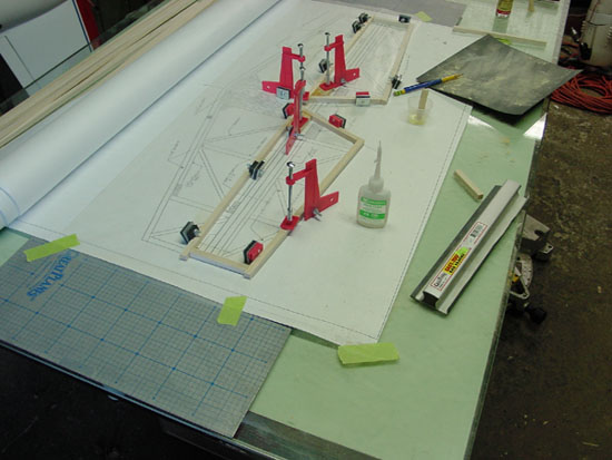

I use a 4'x8' piece of 3/8 glass to build on. It is perfectly flat and anything spilled on it is just scraped up when it dries. For built up structures, I used the GP magnetic building board (see pic below). Check out your local glass shops, they usually have a VERY dusty piece of unused glass that they will sell for some beer money.

sideshow
Magnetic building board
GP magnetic build board on the glass....perfectly flat....regardless of the humidity.
Also what about the table you have it on looks well made, long, can you discribe it, the one that the glwass is resting on -- green ?
My problem is in the size as I ( first time ) want to build a large plane in the 84 to 115.2" and I am having trouble understanding what is possible or not.
Well I was looking more for a base or first up table but this idea I like, what size is the glass and how thick, is it expensive, what kind of support does it need, so it doesn’t crack.
As the wing should be straight , if you fasten it down to a table that is 10 ft. long will the wing have washout in the wrong place and will it be straight if the table is not perfectly flat from end to end and side to side, if I overhang one side of the wing will the wing be straight and have the proper washout etc. on a shorter table.

My Feedback: (11)
The base is an old kitchen table with a thick wooden top, on top of that is a long hollow core door, then the glass. The glass is 1/2 inch thick tempered, I think I said 3/8 earlier, which is wrong.....its very heavy. I went into a glass shop and asked to see what was lying around. I found it with an inch of dust on it propped up on a wall behind an old pinball machine. It was for a table-top that never got picked up. Since its tempered it can't be cut. He said I could have it for $50. If you have ever watched any of the Dave Platt videos it is what he uses, and he builds some big scale aircraft. Thats where I got the idea. LMK if you have any more ?'s.

The glass is 4 x 8 and it looks like it over hangs the long door what size door is on top of the table.

My Feedback: (11)
The glass hangs over about 3/4 inch all of the way around....not enough to matter. I got the door at Home Depot, I think it was around $30.

I have access to a good piece of glass. It's from an old sliding glass door, I took the metal sides off and I do plan to use it the same way you do.
My questions are, how do you hold the parts down like the spars directly where they are supposed to be?
Do you place the plans over or under the glass?
