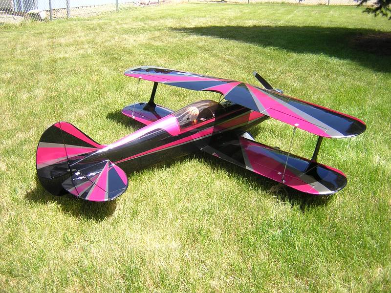

I use windex to apply the Monokote trim pieces. I let them dry overnight, and then lightly go over the trim with a trim iron on low heat. Use a light touch. Scuff with scotch brite, and dust a few coats of clear on before a final heavier coat. The following planes all have monokote on paint (cowls, pants).
