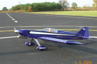

Although I'm no expert with Monokote, I had no problem covering the balsa cowl on my Venture 60 with one piece of Monokote. Here's a picture...

Redford, Beautiful job. Any problems with engine overheating?

Nope. Enough of it hangs out the right side that overheating is now problem.
Here's a picture of that side, which is less pretty, but functional.

Dave, how did you manage to get around those compound curves with just one piece of monokote?

There are actually only three sides to it (since the right side is mostly open). Start with the Monokote on the middle side and pull it around!
