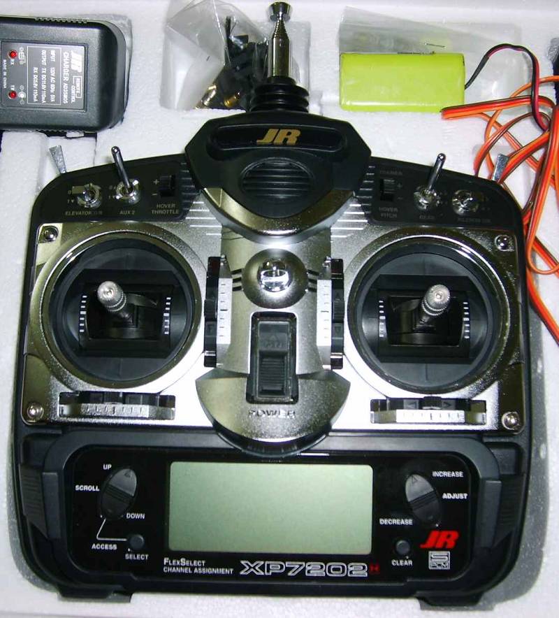

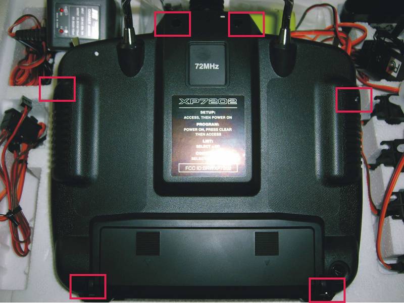

I have purchased a JR XP7202 Mode 1. I thought I can change the mode . Oh nooo this version can not be convertible . Firm upgrade is needed to convert this. No problem let's open the box.. there are 6 philips screws to be loosen.
