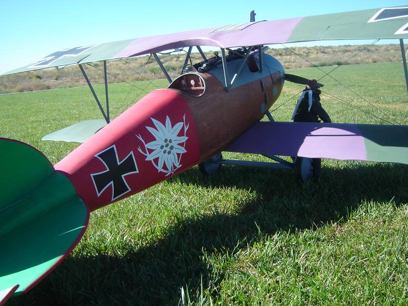

Hello expertens,
On some of my scale planes, after I ultracoted the plane and painted, using the iron is out of the question should I need to remove some wrinkles. The problem is when you use the heat gun, the seams pull away and in turns destroy the model. I have found the acrylic paint, clear Lustercoat and water slide decals can take the heat without any kind of deformation but not the UC. A few days ago, I had to strip and redo my Fokker DVII because the seams start to pull way. So what should I do in case like this? I hate to spend TONS of hours on the plane then have the fiasco like I did few days ago. How do you all handle in cases like this? DP

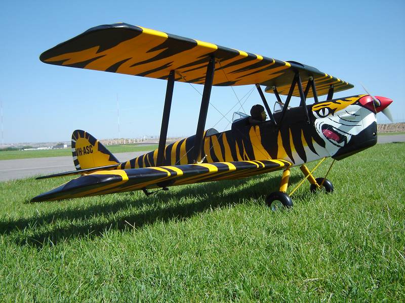

I would love to as these are my planes that I did in Solartex. However, with small scale (40"WS), fabric is too heavy. DP

dai build them a we bit bigger your finish work is excellent .you wont ever get that look with monokote.I wish I could match your skill.
