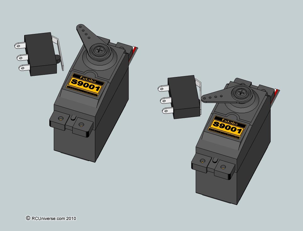

Why not use the throttle servo or retract servo to activate the landing lights? If you have fixed greag you can use a micro switch to activate te landing lights when the throttle is cut to landing speed.

I don't know if an ESC will work. I usually just have the throttle servo hit a microswitch.

Can you post a picture, or one of your great diagrams of this type of a setup, I am having a hard time seeing that working given the mechanical traval of a servo compared to a switch.

There is a micro switch that you can buy at Radio Shack for about 3 or 5 dollars (I forget exactly, but it's cheap)
Just mount it along side the servo so that the servo hits it when you want the lights to go on.
Thanks again for your advice.
When setting up the switch with a servo you will have to use the ATV function on your 7C. The ATV function will allow you to match the servo throw to the switch. ATV is also really handy when setting up throttle linkages.

Minnflyer, you never fail to impress. Thanks for the graphic. I see what you mean, In my mind I was imagining the very small switch that is already part of the light system which only has a throw of maybe 1/8"
http://www.scaleflying.com/PhotoGall...&PhotoNumber=4
The switch you show above would work very well. Also see the below thread I started in the electrics area regarding the ESC as a switch. It just may work as well. Just needs a little more experimenting.
