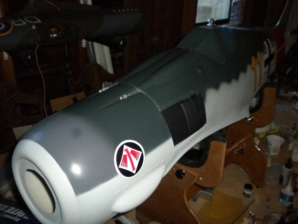

Old 06-21-2010 | 10:56 PM
My Feedback: (13)
Joined: May 2004
Posts: 4,177
From: san francisco, CA
Default RE: Spraying latex
the previous posts are pretty much right on, Floetrol by flood, and windshield washer fluid works for spraying water based material,there both detergent based products which help the flow of latex,and like corectly stated break the surface tension, but its not a major factor when spraying models because of the minimal amounts of paint used.
WWF has alcohol which also aids in drying since it evaporates quickly, but unless its cold out its really not necessary, and when using light colors the blue tint can affect the color of the paint.
I will add about 5%denatured alc. to tap water when I am looking for quicker dry times or when its a bit chilly or humid out
I use about 35-40% water and slowly build my coats up using my touch up gun, rather than less water and heaver coats, just enough paint to cover the surface is good enough.
when I use my airbrush I thin a little more 50% water, at about 25- 35lbs. pressure,if you use a short hose, say less than 15ft then a water trap helps, but I usea 50' hose for my nail guns, and have not had any water issues, since a model is so small, moisture gets trapped in the long hose if there is any, if you live in a humid area then its more of a issue than where I live near the coast.
as for paint my personal favorite has been www.warbirdcolors.com paints there actually catalized urathanes, similar to catalized floor, and funiture finishes,and are fuel proof when catalized.
I have had really good results with the Benjamin Moore Aura line, it has very good coverage with less material used, I know some prefer, or decide to use, low quality materials for spraying models, and they work fine, something to consider when choosing paint, high end material, B M,Sherwin Williams, etc... tend to grind the raw materials to a finer finish which allows the paint to flow through the gun easyer, the base resins are also of a higher grade, and the price diference between a qt. of low end Vs.high end paint is negledgable your results and tool life will benifit from the couple of extra dollars spent, personal preference of course.
as for clear coat the warbirdcolors has a good satin clear for fuel proofing, I have also had luck using Varathane Diamond floor finish as long as the clear has had a few weeks to fully cure its alcohol resistant, meaning wipe it down after your flying day or it will soften up if raw fuel is left on it for extended time,oil based Varathane is fuel proof but has a slight yellow tinge to it when sprayed over white.
these are my observations so far in the modeling area using water clean up materials, some examples of water based paint, my Top Flight P-47 60 kit painted with warbirdcolors, and my repainted ESM FW190 ARF painted with warbird colors and BM Aura house paints.

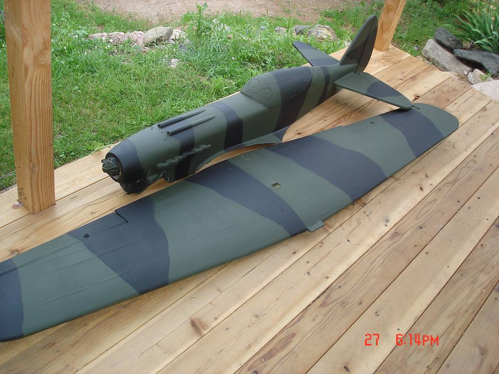

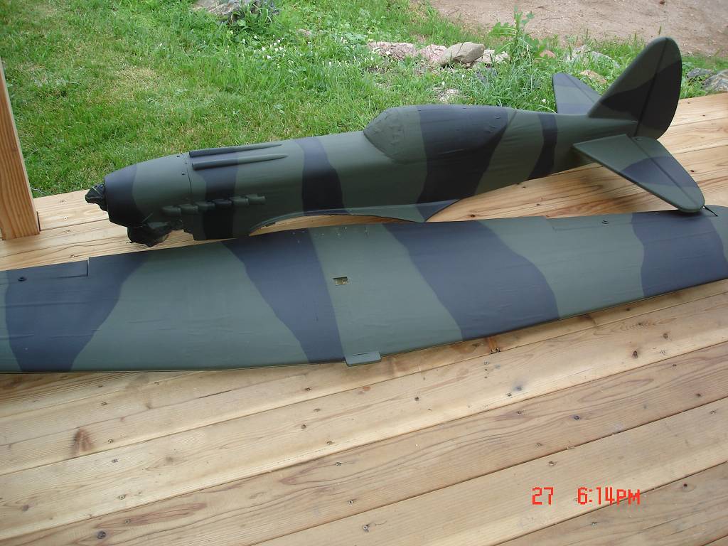

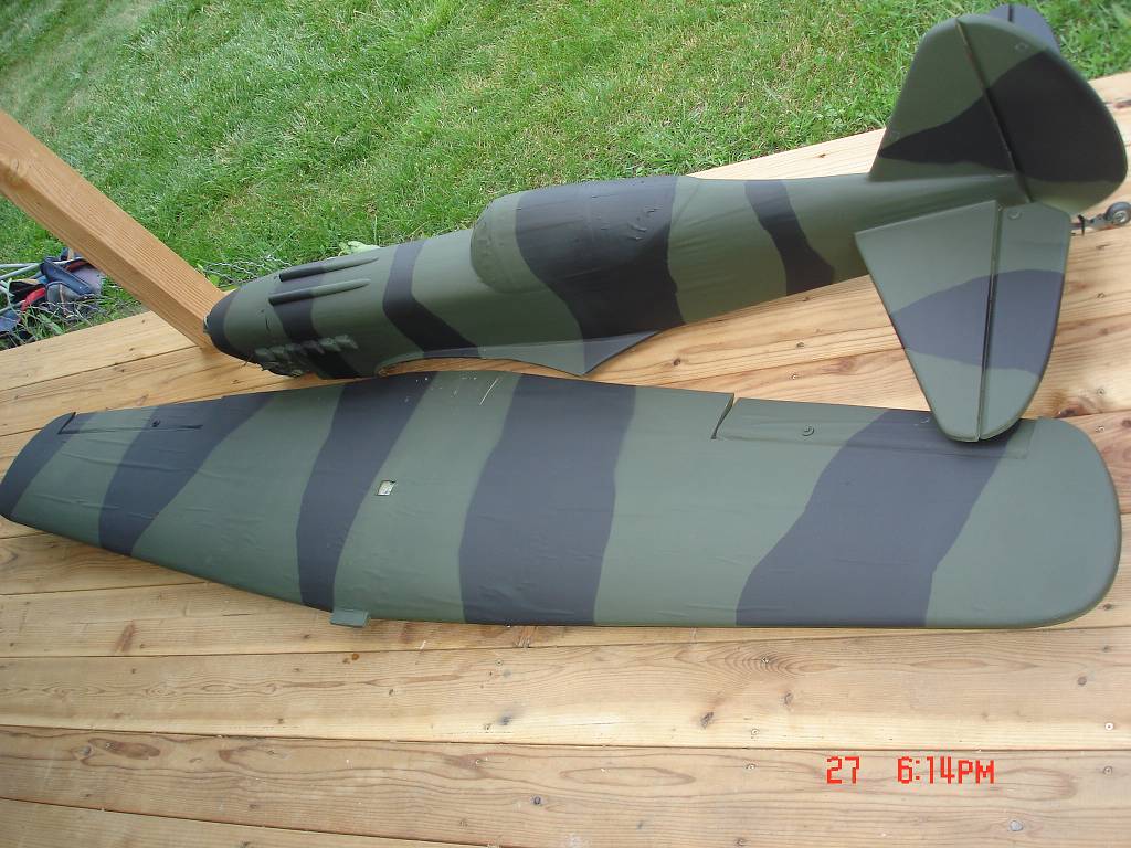

Old 06-27-2010 | 11:18 PM
vertical grimmace's Avatar
Joined: Mar 2004
Posts: 7,277
Received 13 Likes on 12 Posts
From: Greeley, CO
Well, I got the mig painted today. i need to do some detail work but it worked quite nicely. It took a little bit to get everything sorted out. It seemed to like 40psi the most and thinned maybe 1/2 and 1/2 . looks really good. I did find a bottle of Nelsons clear that I have lying around. i may try that. I am not sure I have enough though. Only one little pint bottle. Will this go over the Latex OK? I used Behr. I do have the little catalyst bottle for making the Nelson's somewhat fuel proof.
It did get a little wrinkly as i was letting it sit out in the sun. I have sine removed them from the wing. I was painting over Solartex. It will be quite lovely I believe when it is all done.
