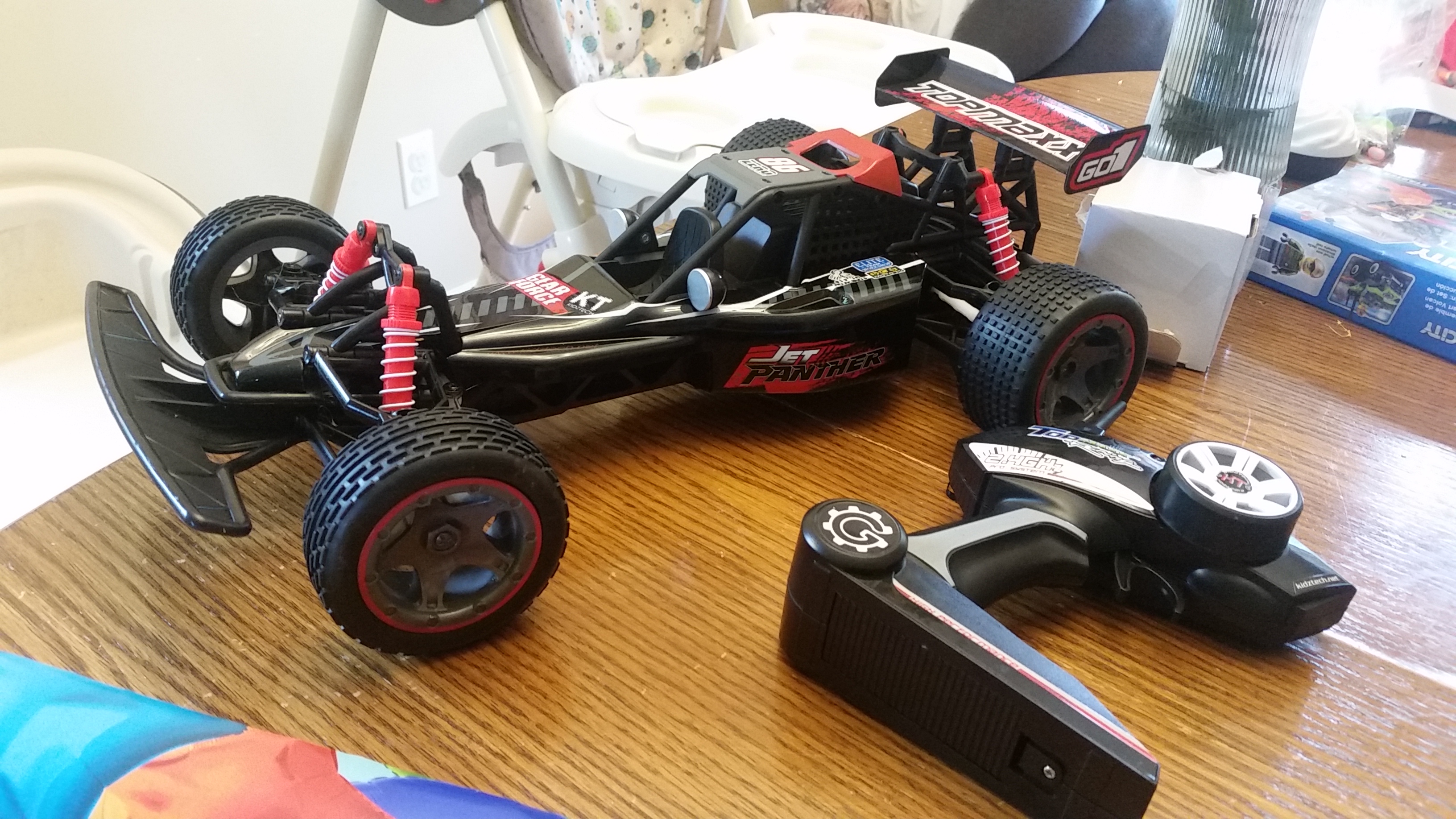

Hey guys, I just bought this car for my son, and it seems to have a bit of potential for a toy grade rc! I can't find much about it,but has anyone here done any kids on one of these? Seems like hobby grade shocks would fit quite nicely on it! Maybe even a brushless motor.. Here is a pic of it

Hey vintageshack. looks like a cool toy man.
it does look like hobby grade shocks would fit and maybe even some good tires. i'm not sure going brushless would be a good idea but if you want to go for it. if it was mine i would stay brushed but upgrade to hobby electronics, get a better ESC and run it on lipo power but with caution because there is a good chance the gears are plastic and can melt from the power increase. you could even put some LEDs in those light buckets for nighttime runs. you should open it up and see if there is room for a servo up front. it kinda looks like the steering is setup on the rear of the front tires. if so the servo may fit pretty good.

I haven't had it apart yet because my son plays with it every day! This thing is fast!! I'm not sure, but its possible it has a brushless motor to begin with! The battery seems pretty good too.. a 1300mAh 9.6v Lithium Ion that holds its charge for quite a while! It definitely needs better shocks though, as the current ones just pogo the car when it goes over any bump.. Tires are a must too.. its good on the gravel, but not so much in the grass.. The radio is a 2.4 ghz instead of the usual 27 or 49 MHz ones you get in the smaller cars..

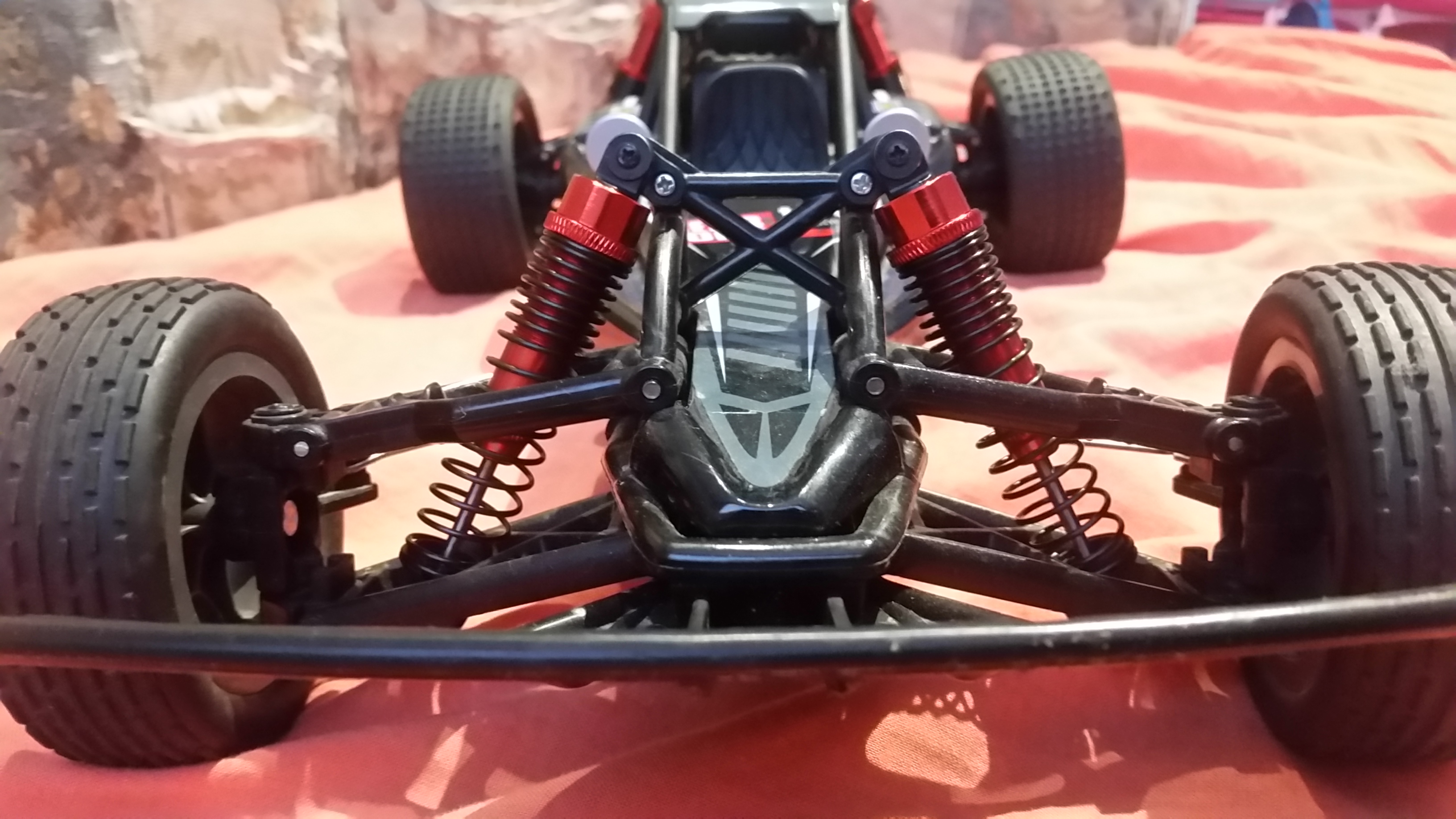

I decided to try the hobby grade shocks and they fit perfectly! Well, semi perfectly.. I had to remove the plastic cover from the motor to clear the shock.. These are nice because they are adjustable.. With the stock "shocks" the rear was bottoming out all the time.. I will definitely look into upgrading the bearings too. The rear wheels are pretty loose already..

Sorry! No updates at this time! I may try to get a set of gripper tires for it eventually but it has been working pretty good lately!

Hey that sounds good, still havin fun with it !
Also the shocks look great !

I have to replace the rearshocks of the topmaxx jet panther, because they got broken.
Can you tell us which shocks exactly you used on the picture, that you have posted on the 12-29-2016?
What is the correct length for replacing the shocks?
Thanks for your help.
Old 02-24-2018 | 04:10 AM
Joined: Feb 2012
Posts: 92
From: Appleton, NL, CANADA
Hey, sorry for the late reply! I ordered these from amazon.ca: https://www.amazon.ca/gp/product/B01...?ie=UTF8&psc=1
If the link doesn't work, they are 4 inch long shocks for a 1/10 scale buggy
