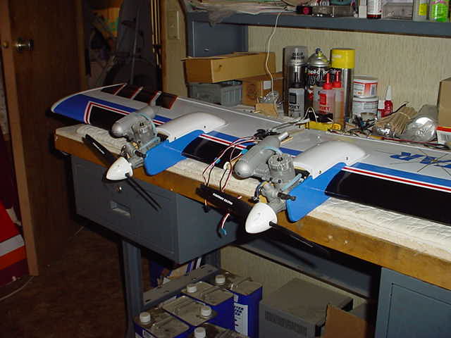

I uused to have the hobbico twinstar, but it crashed when the left engine went out. So I took the parts off of it and stuck it on the Hobbico Avistar. Now I have a high wing twin, running two O.S. LA 46's. It's fast and it can still fly like high speed trainer. The high wing makes it a little more stable than the Hobbico twinstar.
Joined: Sep 2003
Posts: 2
From: Bala Cynwyd, PA
Several web sites provide product reviews for the Hobbico Twinstar. RCM and MAN have long articles. All say the plane took off fast, climbed well, performed all aerobatics, flew very stable, wings level in stalls and slowed down well for landings. I suspect the latter is the result of super-draggy nacelles. Some complained about small fuel tanks and 6 minute flights. One warned that engines larger than .32s, especially ball bearing .40s, will make it go so fast that the stab can be cracked during a pull-up. Fuel storage for .40s would also be a problem.
I am trying to avoid the engine-out problem by modifying the whole kit with a YS53 mounted inside the cabin, buggy-type cog belts running inside the wings to drive counter rotating props, smooth nacelles with ball bearing aluminum shafts, cheek air scoops made from wheel pants, removable belly air scoop which doubles as hot air dump and encloses the muffler at the rear, additional aspirator hot air dump at rear fuselage bottom, cabin rear windows (4) cut out and repositioned to dump hot air, cabin top/windows removable as a 17" long hatch, starter system made from a Jacobs chuck, wing roots located at the fuselage sides and secured in 6 places, aluminum dihedral brace reaching out to the 3rd rib on both sides, cored-out ribs forward of the spars made of 1/2" ply, large under-wing hatches for access to the drives. These changes add about 3" to the wingspan and widen the wheel track. A few items still remaining but hope to be in the air soon. Members of 3 clubs are waiting to see it fly.
Posts: 20,205
Received 20 Likes
15 Posts
From: Mary Esther, Florida, FL
Russ:
You will definitely have done a complete elimination of having offset thrust due to engine failure. But you will also have brought needless complication and complexity to replace it.
Have you checked to see how much power you will lose in the belt drives? How about the prop shafts running in greased or dry bearings? How long will they last at 10K rpm?
And how about... Never mind. Either you've done the engineering or you haven't.
I'll just point out that remote props have been tried many times, and abandoned every time. Wilbur and Orville had remote props driven from a central engine. And a modern development that could have used remote engines did not - the YF-22 Osprey - because of the transmission losses.
If yu've ever wondered why a helicopter's transmission gets so hot, it's those same losses.
I do not say it wont work, I just say there are better, and proven, ways to do it.
Bill, the naysayer (For the moment)
Joined: Sep 2003
Posts: 2
Please note that the prop shafts run on lubricated ball bearings. These are flanged, Conrad type, angular contact bearings made by Barden. They will be operating nowhere near their DN rating. If they fail, they will be replaced with router ball bearings. The cog belts and drive pulleys are the the same equipment that drives 6 lb. buggies at 60 MPH across parking lots and race tracks. The engine to prop shaft ratio is 6 to 5; 6 engine revolutions produce 5 prop revolutions. It is more fun to try this than it is to scrap the idea and put in two mundane .25s.
My Feedback: (21)
Russo247....
....I don't mean to sway you from your plan, Sir....but wouldn't small nuclear reactor, with a couple steam powered generators
running some H.D. electric motors work just as well on the
trainer...? You could do away with those troublesome belts,
as well as the fancy bearings and such....
....of course you
could still use the rear window, and fuselage cooler/vents
to keep the fuselage from melting down.
I do agree....the modified/streamlined nacelles would be
beneficial with the trainer format....just for the acceleration,
and top speed alone....and also the .25 glow engines would
be mundane....at best.
Why don't you try this....alot of the Fellas (including mysefl)
have found the answer to the "mundane problem" by adding
more power to the model....in the way of a couple of .40
sized engines. What a concept....they fit right into the existing
mounts as well. The vertical performance goes right up to
the "outstanding" range....but you might find that a complete flight at a full throttle setting....might be a bit more than you
had in mind.

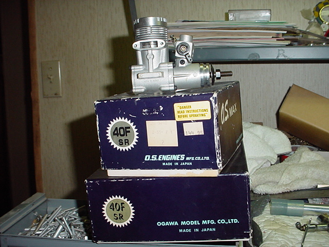

If you really wanted to blow the covering off the Twin Star
trainer....you could substitute a couple of these old fashioned
OS .40 FSR engines to the apparatus....but I don't think it
would last too long....
....never mind....
