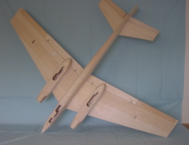

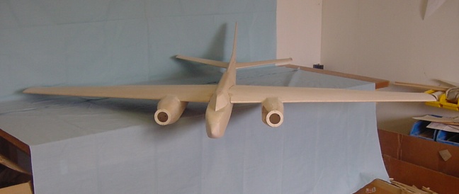

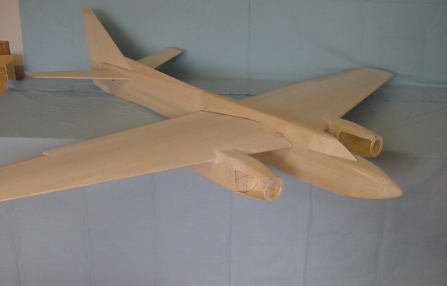

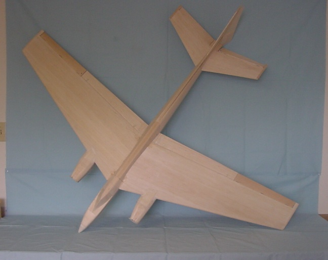

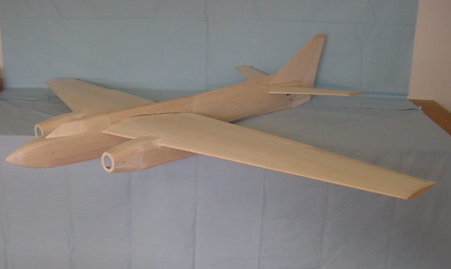

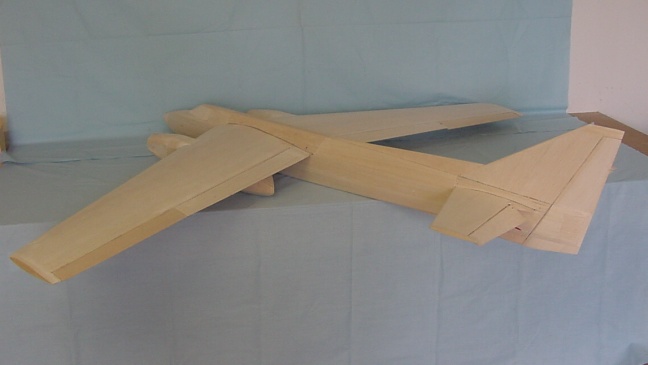

The unveiling of my newest twin, the Xplane. Major construction is complete but still needs filler, final sanding and fit checks before covering. All components will be installed and balance check also performed prior to covering.
The Xplane will be powered by 2 TT Pro .46s and uses Rhom retracts (had them just sitting on the shelf gathering dust, so why not use them) and flaps.
Specs:
Wingspan 68.75", Wing Area 752 sq. in. Wing Anhedral 2.5 degrees
Wing Incidence; Root +0.5 degrees, Tip -1.5 degrees LE sweep 21.5 degrees
Length 58.5" HStab Dihederal 5 degrees HStab Incidence 0 degrees
HStab LE Sweep 25.5 degrees
Weight; As shown 3 lbs. 2 oz. Projected finished weight 7-9 lbs.
Jim

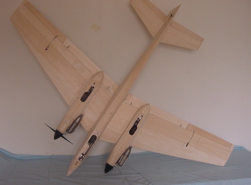

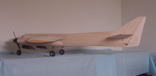

Default RE: Xplane Unveiled

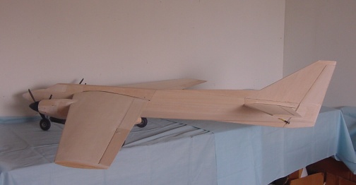

Engines, fuel tanks, radio and retracts have been temp installed. Weight as shown is now 7 lbs. 14 oz. Initial balance check shows that I will have to add 3 to 4 ounces of weight to the tail. The Xplane will use a remote glow attachment. The plug and switch (to select left or right engine) are located just forward of the nose gear.
