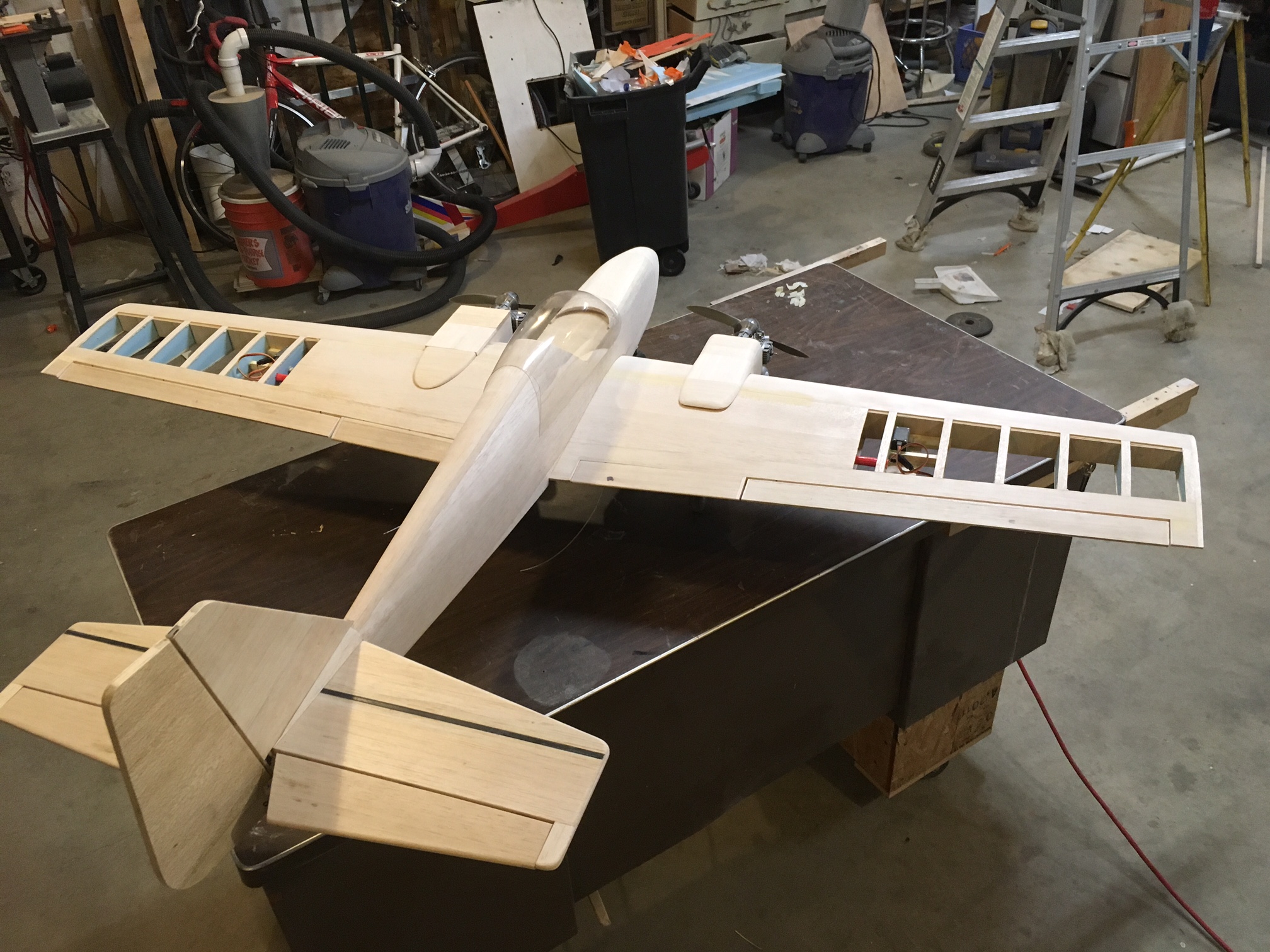

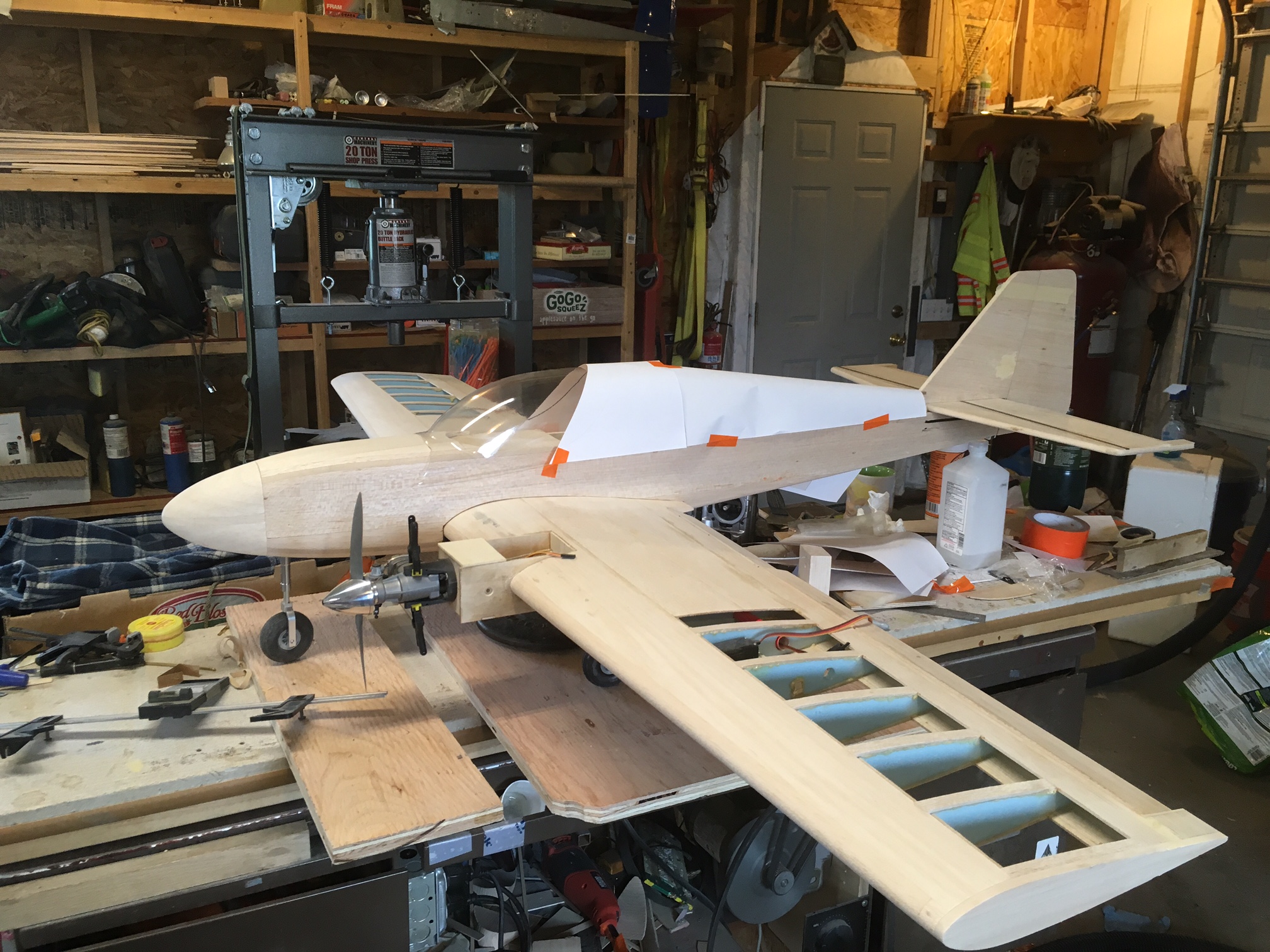

I got a good start on my scratch built twin. Still need to build a turtle deck and the nacelle trim and cowlings. The wing is similar in shape and airfoil as the Ultrasport 60 with a slightly longer wingspan (71"). The fuse is just something I drew up. It is similar in size and shape as the Southern Eagle. It has flaps and retracts. I am trying to keep the dry weight right at 8 lbs. That will give me a wing loading just under 27oz/sqft. with 12 oz of fuel. I will have two ASP .36 engines with 10x6 props. I was hoping that one engine would pull it along after it was in the air just in case of a dead engine, but I don't think it is going to be enough. With my twin engine Seamaster, 7.5lbs, one ASP .25 will take off and fly around but it has a lot more wing area. I have built in 3 deg. of out thrust on each engine.
I have two .46 engines but with 6 oz of fuel in each wing, they wont fly very long. Plus they would add an extra 1/2 lb of weight.
Well anyway, here is a picture of the progress so far. Hoping to have it ready for covering in a couple of weeks.
I know the table is quite messy right now. I seem to clear it off every week and it just keeps getting full of junk.

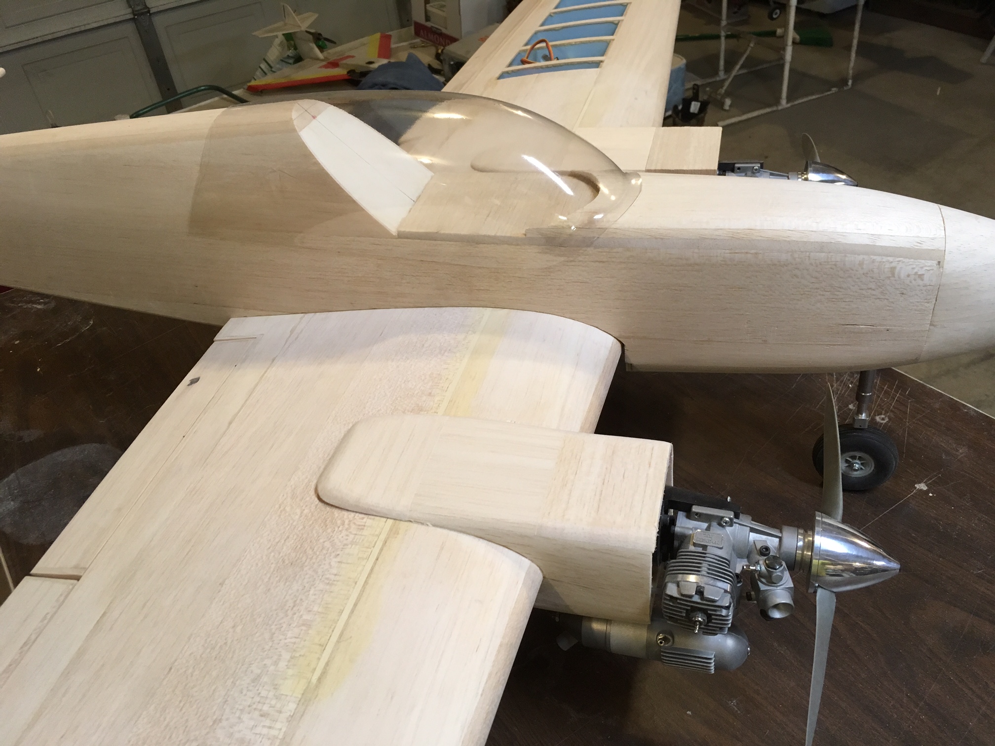

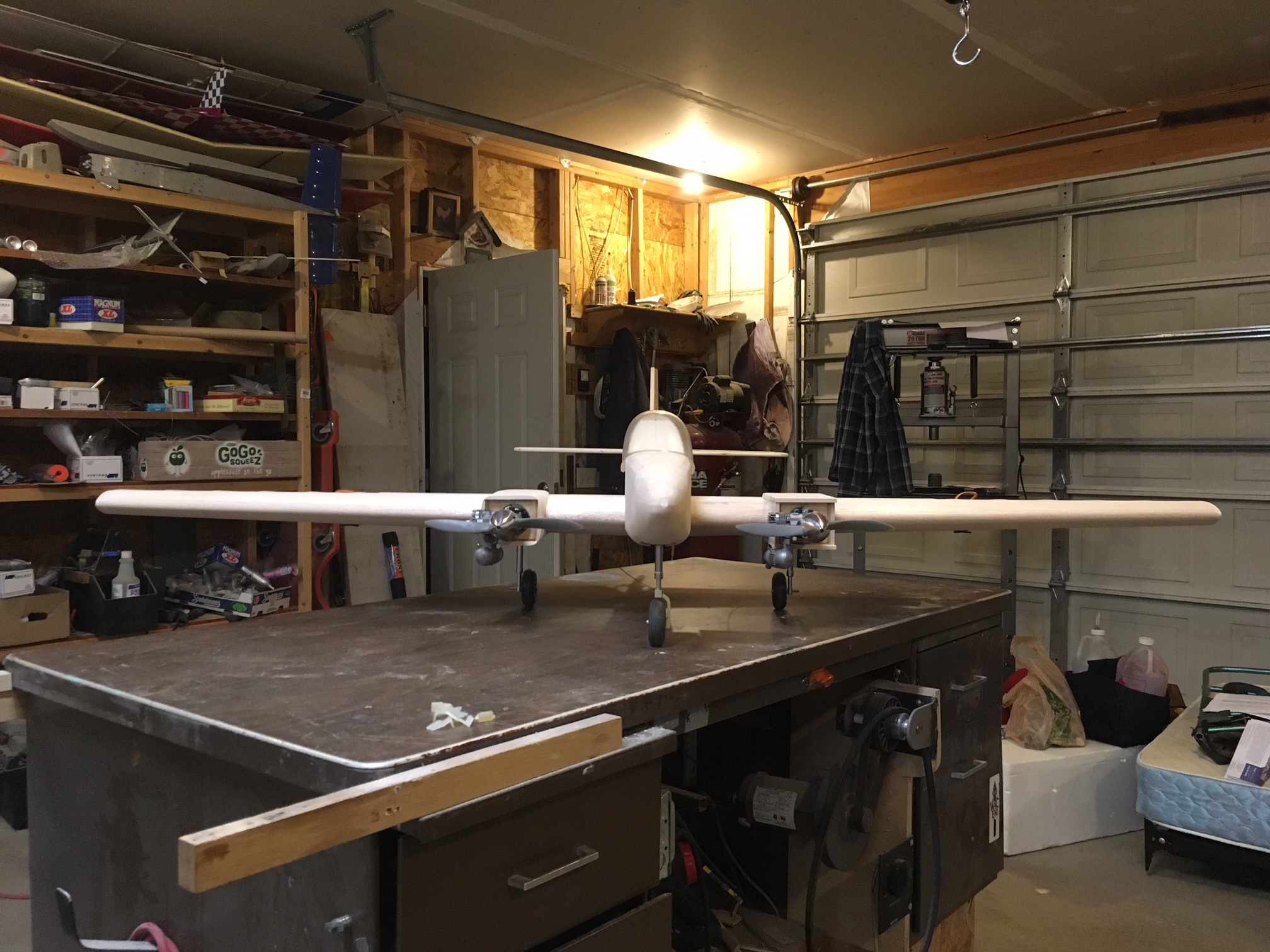

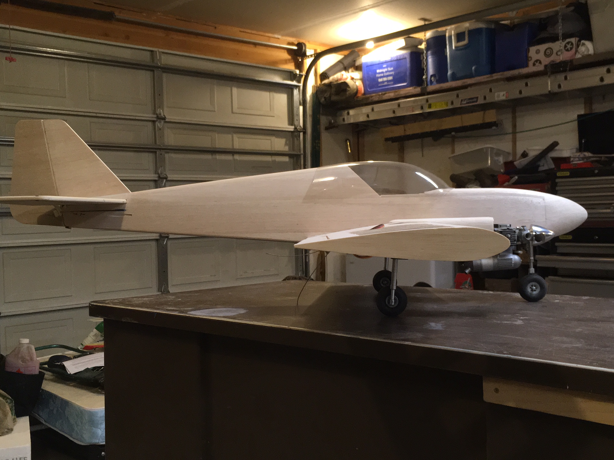

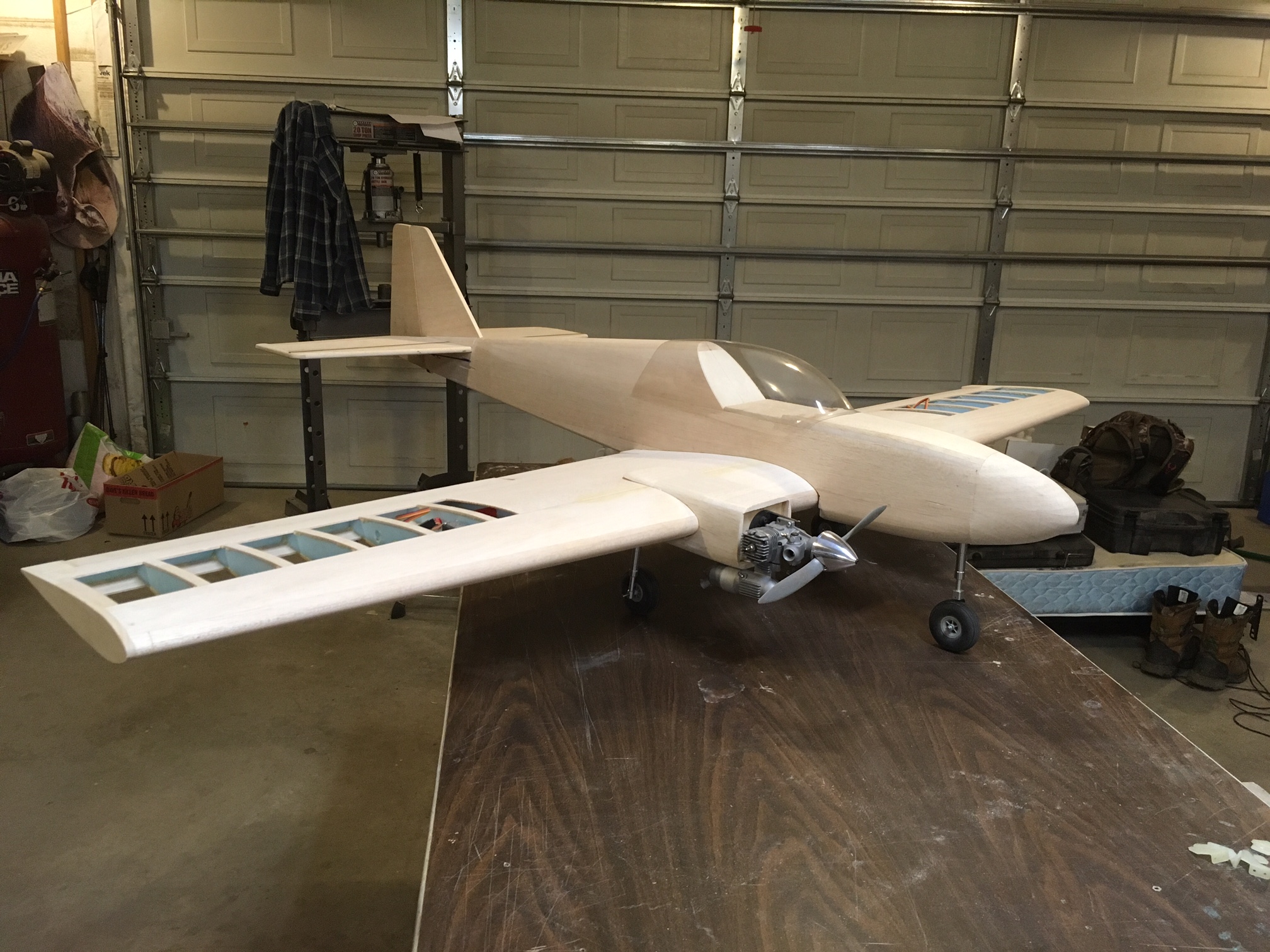

Just a little bit more done on it. Still a bit more sanding left and need to build a couple cowls. Hoping to cover in a week.

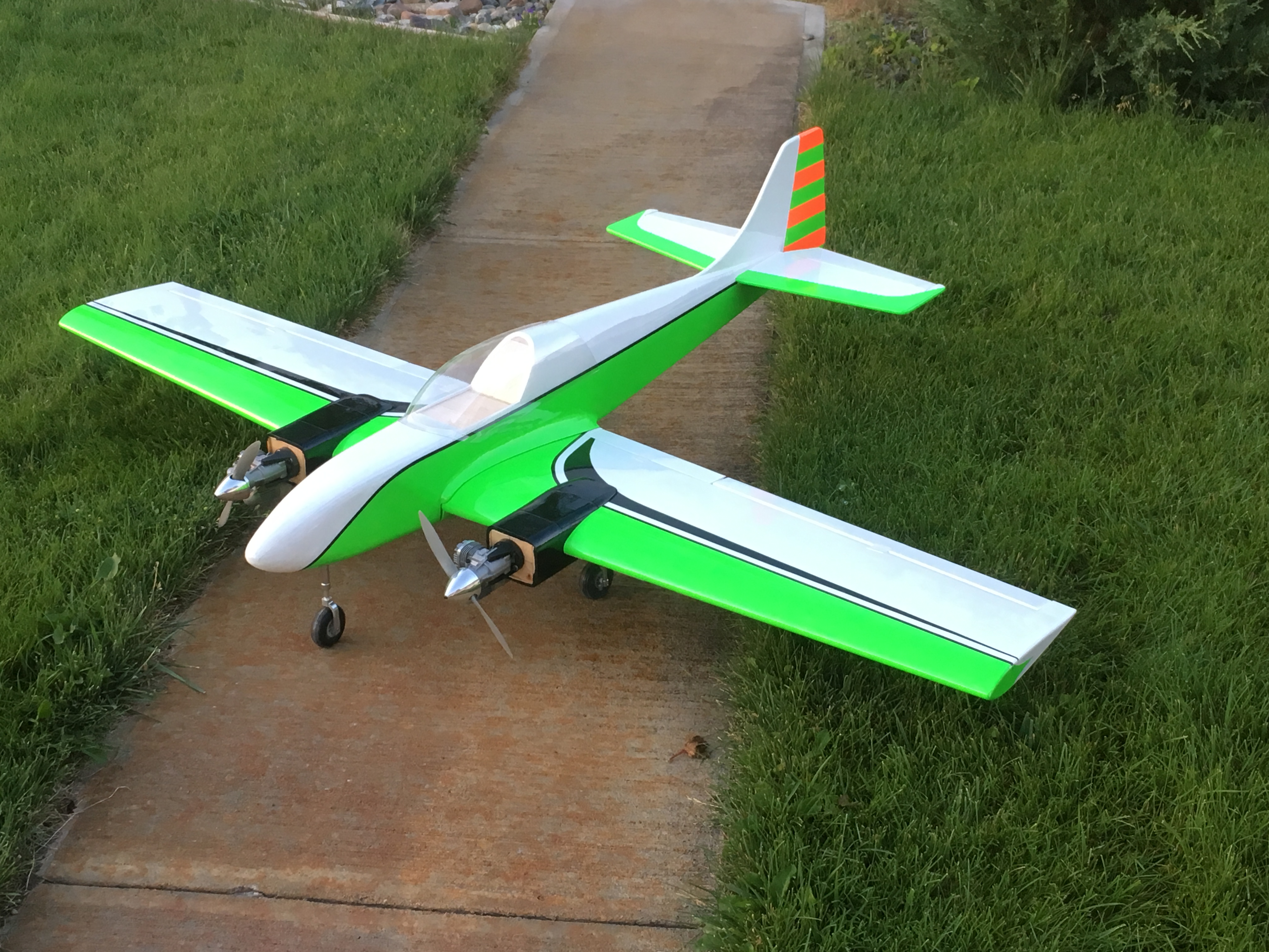

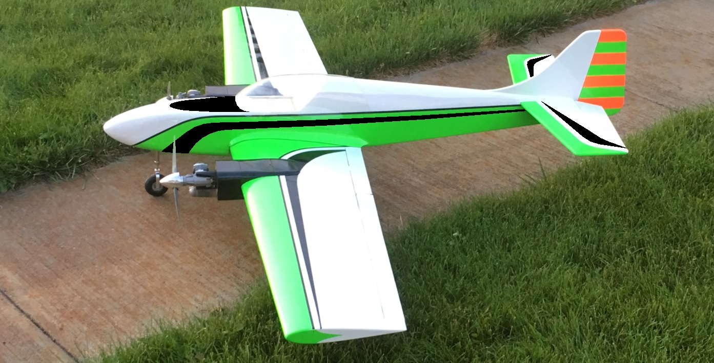

[ATTACH]2170453[/IMG]Slow and steady. Just needs a little more black trim but had time for a photo op so snapped a few pictures this morning. I forgot how hard it is to do a decent job covering a model and how long it actually takes. I have made a few mistakes with the covering so far but if I don't tell you about them then you might not see them. Just need to hook up control surfaces and cut and glue canopy, make up some cowls and break in engines. I will put them on a test stand for the break in. The second picture has the computer generated trim that still needs to be added.[ATTACH]2170454[/IMG][ATTACH]2170453[/IMG]
