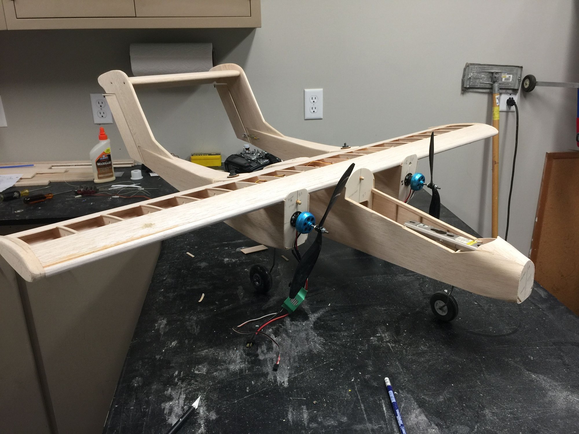

I'm building an OV-10 electric and don't know if I should use counter rotating motors or not. First of all will a brushless motor run backwards as well as forward (same power)? I know if you reverse two of the three wires it will run the other way. Counter rotating; I've saw were some people say it doesn't make much difference. What do you think??? I'm new to twins and have plans for more.

If you can get the prop then yes, its worth doing. If it's not a common prop size then I wouldn't worry about it.
There is no running backwards or forwards, however you hook it up it runs, it doesn't know or care which way its spinning.

The only time I've seen this required is when the X mount needed to be on the front with the motor recessed into the fuselage or firewall as opposed to having the mount on the back of the motor. Not to reverse the rotation, again, there is no reverse rotation on a brushless motor, its merely a factor of how you have to mount it and what prop you're using, if you need to spin it the other way, as you already said, you reverse two wires.

The electrics can be a bit confusing. We all got accustomed to glow engine displacement and the very narrow range of props they are able to use for a certain displacement. Current brushless electrics are far more flexible. First thing is that the motor does not care which direction it is spinning. Back in the days of brushed motors, the timing of the motor was determined with the contact location of the brushes on the armature. With brushless motors the timing is purely a function of the speed controller. In some cases with the larger setups the timing is user adjustable. Faster spinning inrunner motors require low timing, 0 to 5 degrees while the lower rpm outrunner motors such as what the OP has requires high timing, 20 to 25 degrees. Most of the lower cost, smaller stuff will be plug and play but you do loose a little bit of efficiency. In order to select the correct size prop you need to know the KV of the motor, what voltage you will be running, the motor diameter and the motor length. For example one of my electrics has a 63mm diameter with a 55mm length. The KV is 230 and I run a voltage of 38v. Multiplying the KV x V we get 8,740 rpm. The prop selected is a 21.5x13.5 delivering around 2,700 watts at about 65 amps. If I was to lower the voltage ( thus rpm ) I could fit a larger prop and if I upped the voltage I would have to go with a smaller prop to keep amperage draw the same. I am going to assume that the batteries selected by the OP are going to be 3S or 11.1V, knowing the diameter of the motor and the KV would allow a prop size recommendation. I suggest looking at the APC web site to select props. Robert has in the past few years introduced a number of multi Rotor prop sets in various sizes that may work very well and are quite inexpensive. They come in sets of 4 with two being CW and two CCW rotation. As far as how to set up rotation, I would do some experimenting but I suspect you will notice little or no difference. Good luck with the project, the OV-10 is one of the airplanes that I always liked, Cal Fire has a few flying close to my home often.

I would run them the same direction to keep it simple. After a few twins I haven’t seen any problems with this setup. The only time I would consider counter rotating props is if it was a taildragger to prevent it swinging on takeoff.

As others said, If you can make it work, I feel it's probably worth doing. Sometimes it's difficult to find the correct props. Some planes I have had with both normal rotation were difficult to handle until the rudder became effective where as others it wasn't noticeable at all. Probably more pronounced with tail dragger such as a DC-3.
