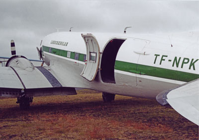

I need nacelles/cowlings for the Kyosho Dc-3.
If someone can sell me for fair price please contact me [email protected]
I'm in Iceland.
